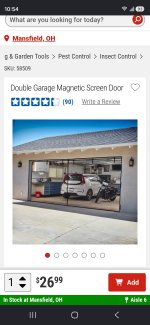

NUTTSGT
Sep 14, 2009
51,280
Northern Central Ohio
HF sells garage door screens for cheap. I'd buy one and just hang it up behind the closed door.
I use them on the enclosed trailer with a piece of PVC pipe as a hanging rod.
