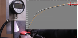

I see that the Ken Tools torque sticks are calibrated using a 250 ft lb pneumatic impact wrench, 1/2 drive. If you use an impact wrench whose torque is higher, you have to calibrate it to use less power to get closer to 250 ft lb.
So now my question is, can anyone recommend an electric impact wrench whose maximum fastening torque is 250 ft lb so I could just use that please? I know there's that claims from the manufacturer are one thing, vs actual maximum fastening torque. Looked at torque test channel and couldn't find anything that low in 1/2 " drive, but maybe I didn't look hard enough.
Any suggestions on how to get an impact wrench to limit it's torque to 250 ft lb max fastening by changing settings, or finding one whose max fastening torque is actually 250 ft lb?

It seems like if I don't want to constantly "calibrate" or to avoid calibrating all together, I need a 1/2 " impact wrench whose max torque is 250 ft lb fastening torque (advertised and actual). I can get one that is higher, and change the speed settings, but then it's still unknown if for example setting is 2 is 250 ft lb or 100 ft lb or nobody knows.
Maybe a Milwaukee 2855-20 whose max fastening torque is 250 ft lb? Not sure if it's worth getting just to use torque sticks though huh?
Not sure what battery torque test channel was using, but when they tested it for 15 seconds it got up to 249 ft lb, and not sure if that was fastening or nut busting either.

Look at corded electric impacts instead of cordless. Much lower ratings. Milwaukee has theirs rated at 300ft/lbs.
Also consider that the bpm is higher with electric then pneumatic, this effects how the toque sticks work.
You’ll want to find torque sticks that are rated to work with an electric impact not a pneumatic one. Or at the least state the bpm that they are calibrated for.

Torque sticks work best with pneumatic impacts. The reason is they have a slower BPM which gives the stick a chance to untwist prior to the next impact. Find yourself an I-R 231 and that solves your problem. I have at least 20 impact wrenches (probably more) most of which are cordless but if you insist on using torque sticks the old school pneumatic can't be beat.

My old Snap-On 3850 is a little below 250 ft lb and works good with torque sticks but the batteries are getting old. I did get the lowest torque stick I could find (I forget the spec) and want to someday try it with my cordless IR and see the results in case my Snap-On battery dies. The IR is just too powerful for torque sticks meant for 250 ft lb.

I am not sure about your exact needs, but my DCF891 has published (approximate) torque limits for each power range. It lists 100ftlbs for Low, 300 ftlbs for medium, and 600ftlbs for high. The smaller DCF921 is 150 ftlbs on setting 1. The 891 on setting 1 is great for lug nuts. If I let off early, I am usually around 75-80 ftlbs and I finish off with a torque wrench.
