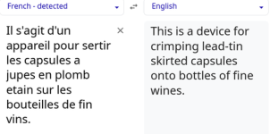

Maybe the hole is for air escaping, or inserting a pick tool to remove a mistake? AI can't translate this page visually. And I'm not entering it word for word :LOL: I did the first sentence from the quote in the below image. Now the real question...Will the OP ever return? :LOL:
You can try using google translate with the phone camera.
