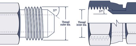

So it appears to be around an M10 flare. It's smaller than 1/4" flare but larger than 3/16" flare. The outside of threads measures 10.36mm.
It's an an ALL Power APC4005 Twin stack air compressor. I believe also sold under Sears, Lowes, Strikeforce and others somewhere around early 2000's or so. They don't sell compressors anymore and only a few random parts left from later models.
I need to add the unloader line from this valve up to the switch since it's not there anymore. I bought the thing for a whole $10...but guy didn't know much about it. Thought if ya put a cap on there it would fill. He stuck his finger over it and it started filling. The pressure switch end seems to be a fairly common M10-1.0 inverted flare that I can work with.
The problem seems to be nobody has an M10 flare nut that would fit it. So looking for options that might work for it.

Should be M10. How’s it not fitting? Too big? Too small? Not threading?
I did indicate M10- flare nut doesn't seem to exist in the US. 1/4" flare is too big, 3/16" flare is too small. I tried an AI that says it's a compression fitting just not common used in US. But supposedly a 1/4" compression nut is nearly identical to M10 and often mistaken

From here the threads look fouled up, maybe try a chasing file?
Problem is finding a fitting that fits it...I have nothing for it. Can't seem to find an M10 flare anywhere. I'm gonna try to buy some M10 nuts and see if they fit right. Some info says it's an import valve sold in bulk to manufacturers. Not common otherwise, others say it's just standard 1/4" compression and threads are nearly identical to M10

-Thread pitch (TPI) is real important, better identify the pitch before attempting a fit. Several inch-to-metric threads fit ok for the first couple of threads but the difference shows up (tighter) after a few threads. Compression angle of the fitting can/will make a difference too as you're probably aware. I'll bet @andyvh1959 could offer better info than I can.

Yea I'm familiar enough with threads and pitches...just trying to find the right fitting. I found a reference that said that fitting is a 1/4" compression just kinda unusual style with a cone and it's 1/4" compression threads which are so close to M10 they're frequently mistaken.

Boy, what a *****. When I search for m10 flare nut, it shows me what you have. When I look for flare ferrule, shows me mostly the same things. What’s the term for the mating female piece?
Google AI says it should be an M10-1.0, so if you have a metric pitch gauge, I’d verify that before going too crazy.
