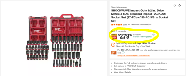

*EDIT* ***This includes both 1/2" & 3/8" drive ***If you interested the Milwaukee stuff, they are running a sale this week for both standard and deeps in packout cases for $280 (doesn't include long impact extensions):

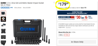

It's really hard to beat the Quinn 1/2" set for the price (shown without discounts) of $180:

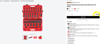

Tekton is a great option too for $385:
