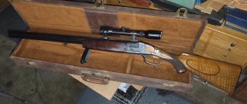

I came into possession of this ~1930 German combination rifle/shotgun. The only way I could afford it was due to a cracked forearm, and I needed to make a shotgun hardcase I had fit. You can see the crack in the photo above, which should be an easy fix...
I removed the forend, spread it apart to get the glue to as much as possible, and started clamping. While it was drying, I started on the case
everything fit perfectly, except the scope, so I cut a notch in the compartment wall. I would have preferred to move the wall, but this case, a $5 find at an estate sale, is better built than that.
Notch cut out, and gluing some of the liner in place
All done!
