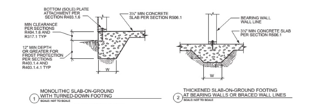

Stumbled across this thread while doing so research for my garage slab and lift planning.
Seems most credible sources show (proper) chemical (epoxy) anchors as having better strength and durability than expansion anchors.
That doesn't mean a backyard mechanic swapping out the factory expansion anchors with the epoxy he thinks is right will be stronger.
As for the "engineered" anchors are best, Yes in general, but the anchors "engineered" may also have compromises due to changes since the original engineering and possible substandard parts being supplied to the lift manufacturer.
Right now my thinking is going back and forth.
a) New "Name Brand" expanding anchors of the same diameter and spec as those in the kit.
Possibly longer, to take advantage of a pad thicker then the specified 4" minimum.
b) Chemical anchors from a "Name Brand" as recommended by them for replacement of a the expanding anchor supplied.
My original thought was to put a footer under the lift location, but more reading is needed as I see that can contribute to cracking.
A second thought was to slightly thicken the slab and put some rebar in the area of the posts and running between them, so any cracking that occurs later is likely not to cross the lift supports.
I al looking for knowledgeable input on this?
There's nothing magic about the "name brand" anchors. They may not even make their own parts. (They could be made by another company and just sold with the "name brand" on them.) Something with a name you see on commercials could even be manufactured to an inferior spec than the parts included with your lift. The anchors with your lift will be made and tested to the correct spec.
Modern lifts do not require or use footers. There are two options for the install: A) A new flat slab. B) A cut-out "repair slab" to compensate for a flat slab of inferior thickness or quality. Many people confuse a "repair slab" with a footer because its deeper than the original slab - but it's not a footer and doesn't mechanically function as one. It's a thickened section that keys into the remaining parts of the inferior slab.
Dramatically thickening the slab, adding inconsistent reinforcing in the slab (only in select areas) or doing other things inconsistent with the (very specific) repair slab techniques will lead to differential shrinking in the slab when it cures. <- This causes the cracking; and it will happen in the places where you don't want it to be for your lift.
If you want a quality slab, paying attention to regular fundamentals of concrete placement will get you the best and strongest slab for a lift. (Go up on the cement content, add a little thickness, reinforce the whole thing, put your saw cut joints in the right places, make your saw cut joints at the right time, etc.)

It is a whole new slab, with footers around the edge and one running the length. (30X40 bldg. with a 12x40 lean-to on one side)
My guess is it will need a stress relief cut where the mid-slab footer is.
I have a good concrete guy, so will discuss with him.
I can see how transitions in thickness and differences in reinforcing could change stresses and maybe show a crack where one might not have otherwise occurred, but considering the size of the area that the lift is in (14' x 3') adding thickness and reinforcing should not bring any cracks into that area, and should prevent any in that area.

Now you are headed right into the heart of where the challenges are. Lifts generally go in the center of the room, which is where the greatest shrinkage stresses are concentrated in the slab...
I'm not sure what you are talking about here, but it sounds like you will have a thickened edge slab with a grade beam running through the center of the building? Will the slab be post-tensioned? If so, you should consult your engineer before planning a lift.
If the slab will not be post-tensioned and if you will have saw cut joints, you definitely want to discuss that with your concrete installer as they could be planning to run one to split the 30' dimension (in the middle) right where you want to put the lift. In this case, you would need them to plan for two cuts and split that dimension in to 10' sections to give you a clear pad in the middle for the lift.
The greatest stresses build up the center of the slab. When you add thickness or reinforcing in that area, the cracks form at the first place of weakness they can find, which is right around the reinforcing and/or the thickened sections. This is why you won't find any of this in any concrete design books or design guides.

The building is a light steel building which sets on the edges of the slab. I don't know if it gets "real footers" around the edge or is just thickened edges.
Since the building has a Lean-to on one side, there the "Center-building" edge comes down 12 feet in and I believe that this also needs a footer. (Since it is in effect a bearing wall)
So that slab is 42X40 (12x40 under the lean-to and 30x40 under the main building)
The lift in in the main section one post about 3 feet form the lean-to side 14 feet in, and the second post is about 14 feet from the lean-to side 14 feet in.
It does seem that they use a thickened slab under bearing walls.
My thought was to do something similar under the lift area, running from a foot or more around each post and even width between the posts (about 3X14)

That looks like typical slab on grade construction then. Those thickened areas should have reinforcing that ties them all together. That and being dug in will make them essentially like an "anchor" in the ground. (Makes sense - because you don't want the walls to move.)
So, you can think of your floor as being two separate "slabs" on either side of that bearing wall separating the interior from the outside covered by the lean-to.
As long as you aren't post-tensioned, your contractor should have a plan for saw cut joints. If you plan those out ahead of time so they maintain the required "crack distance" required by your lift manufacturer (cracks develop in the cuts) and make sure that you have the required depth in the slab, then you are golden. No fancy stuff required.
If I was to do my lift all over again, I would have put stakes on the ground in the area around and between the lift posts to help my finishers get everything closer to perfectly level. (They take the stakes out as they go.) The lifts have procedures for dealing with being on a slab that's slightly sloped, but it's still a PITA to deal with.
The concrete guy said he can get the pad as level as I want (Laser leveled).
We are going to add some slope towards the door and some towards a central floor drain.
I have the area of the lift marked to be dead flat.
Yes, the cuts will be well away from the lift area.
