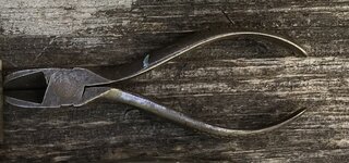

Here are my dykes previously posted in the Snap-on thread. I found it at the late lamented Tahoe flea in 2019. The rest of my vacuum grip tools are all marked Snap-on.
-Don148109E4-9803-44EA-B5A5-05E2B35762FB.jpeg25A3B726-CED7-458F-9112-DDECC8B47802.jpegCD878B1A-8C40-4C68-BD57-2BBC123AD211.jpeg819E49C3-5321-4A8E-AD95-CD38C5016704.jpeg6C67E940-BA0A-40E8-8502-A518EAC86BC4.jpeg
