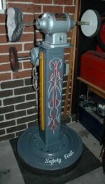

Hello, Just new here! This is an awesome thread, some really good ideas. :) I have been working in a limited space and needed to mount two bench grinders so I could get to them easily. This is my result.
They are mounted on a 90* angled base with a solid pivot in the corner, running on brass bushes. The base is locked into either position by handles each side and is very solid. The base has a drawer underneath and storage for a water grinder.
Cheers,
Andy
