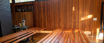

I ordered up some clear fir flooring for the paneling of the stairs. I don't have a clear idea yet of what the stairs are going to look like but I know they will match the walls.
Luckily I have this thread to go back to and I found my "formula" for the perfect stain for the boards. I bought more Amber Shellac and dedicated one quart to the stain: 500ml amber shellac, 10ml medium brown Transtint, 1ml golden brown and 1-2ml red brown. I upsized the ratio for the larger amount.
Because our paneling is flooring you don't usually get to order it in lengths - it comes in random lengths and you just get it by square footage. My lumber yard was able to get me 13' lengths but I did my calculations on 8' lengths and when I ordered I called out the wrong number from my notes. So I have a lot of extra which isn't a bad thing since it usually takes a while to get. I'll find a use for it.
Since we're in the rainy season we have to do the finishing inside. So new cat toy.
Lara and I tag teamed these since it took a while to get them done. The process is this: sand with 150 with the Festool sander, one coat of amber shellac, dry, second coat of tinted shellac, dry, some boards get a mid second coat - essentially a heavier second coat to make them darker for variations sake. Shellac dissolves itself so the first coat seals the grain from the stain and the second is the color.
You can't do a third or you'll lift the second and then it's game over. Next is clear satin polyurethane on top of the dried shellac. This is supposedly a no-no but then all the things I'm doing are supposedly wrong but they work. Once the first coat of poly is dry we hand sand that with 220 to just knock down the dust nibs being careful to not sand through into the stain - another game over scenario. Finally another coat of poly and we're done. Poly is put down with a small roller.
Boards in process - from back: raw, amber and finished.
And doing it in the dining room is how you know you got it right - they match up perfectly in all the different light.
Love the flooring and the color.
I did the same thing on a workbench surface using MDF but made sure the shellac was wax free. Sealed great and the satin poly made for a nice surface....
