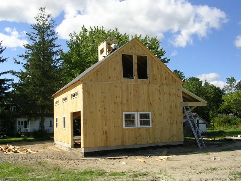

After years of wanting to build a new garage/barn for my cars and other uses, I finally was able to get started last month. After looking into stick-built, Lester, and Morton, I stumbled across a website for a barn builder from Vermont. I already have an old barn, and just love the way they look, so I went with Geobarn. My experience thus far has been awesome. In eleven working days, I went from a bare foundation to this:
The crew consists of myself and two young (30-ish) barn builders. I've never had such a pleasant experience with a builder/crew in my life. The windows/trim and other et-ceteras should be done within another four or five working days, then I can move on to all the finishing work, concrete floor etc.
The barn is not huge, at 24x32. But, it has a full upstairs, walk-up cupola, and will shelter two F-bodies and one A-body inside, and then my truck underneath the 8 foot overhang on the north eave. If I were richer, I would have built bigger. But, I do have another barn and a small garage here as well to assist with storage and workspace.
Just wanted to share, after years of looking at everyone else's projects.

The barn is almost finished. Well, in the sense of the structure itself being built...there will be much to do one the barn builders leave! But, tomorrow should be the last construction day, for a total of sixteen days of construction work by 2-3 people each day.
Here are some more shots, including some of the cupola that one of the builders and I worked on yesterday. It's built like a pillbox, and offers some great views.

Bull, I have to ask why the windows under the porch roof?
lol, a valid question.
Those windows actually do allow light into the upstairs, more than you might think given that they are under the cantilevered roof.

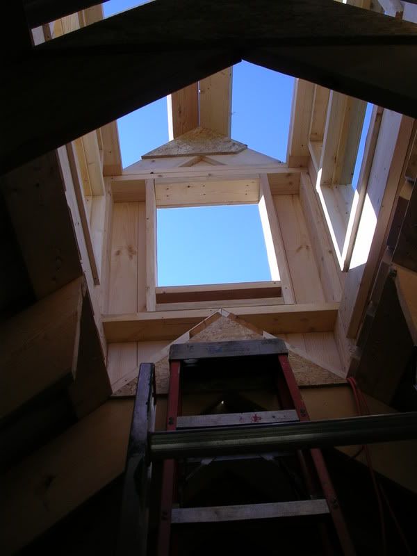

A very minor update. The third, odd-sized garage door was installed recently, so the structure is now weather tight. AI still haven't passed my final inspection due to the building commissioner being sort of...rigid. As soon as I do, I will feel like I can start moving in my tools and such.
B
Bull
Dec 12, 2005
16,189
My barn passed the inspection today...hooray! We ripped out the stairs and put in a ladder, to solve that issue.
The commissioner signed the inspection card, and said the building was ok "except rafters cut for cupola need to be headered" referring to the one set of rafters cut to gain access to that space.
My question is, since she signed off on the building, why would she note this issue, and what is my motivation to address it?
Thanks in advance.
Thanks in advance.
First off that is a grat looking building. As for the motivation factor, the inspector could give a follow-up inspection to see if you took care of this issue.

I agree with you on the professionalism - she should have been thorough and listed that issue before her final inspection. Maybe it was an oversight - something she missed. But it wasn't exactly hidden. Why did she mention it now? Liability. She brought the problem to your attention.
Yes, there should be a header across the ends of the roof joists. Simple matter of framing them in and I'd go ahead and do it as you have the potential for those joists to sag over time.

Let me take a pic of the cut joists, and perhaps you can explain to me how to header them properly. The issue will be one of maintaining the open space inside the cupola...the entire reason for cutting the joists in the first place lol.
PAToyota
Jan 20, 2006
4,366
South Central Pennsylvania, USA
Header goes across the face of the cut joists - perpendicular to them. Cut a piece that will span from the full joist on one side to the full joist on the other side, toenailing into each of those. Then nail through the face of the header into the end of each joist. Does that make sense?
The joists are visible in post number 11 (pic 7). Looking at that picture, just cut 2 boards. The boards will run from the rafter just before the cupola, to the rafter just after the cupola. So using that 7th picture, one would run down the left side of the pic, the other other would run down the right.
The ends of this "header" would be connected to the uncut rafters, the middle would be nailed to the end of the cut rafter.
