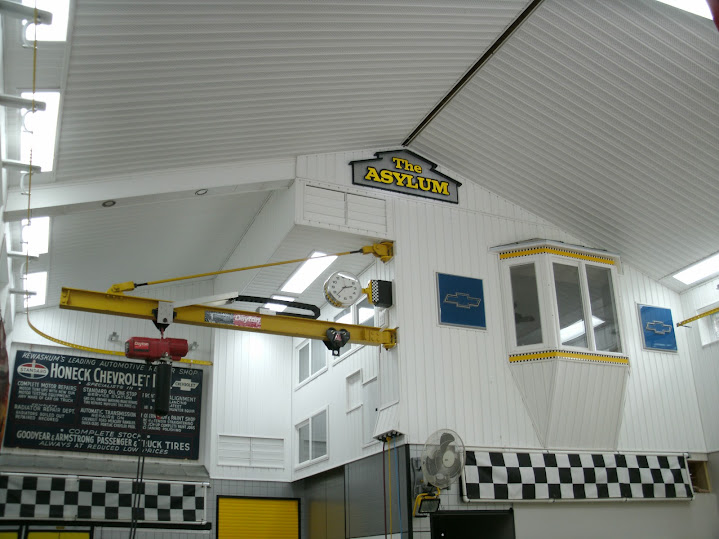

The walls (above ten feet) and the entire ceiling of the Asylum will be covered with T4 vinyl by the time I'm done. I'm amazed at how easy this stuff is to work with and I'm happy with the results. A 16" spacing should be fine. Check my build thread out for many more details about it (index will lead you to relevant posts).
Liked it so much, I've covered a 330sf patio ceiling at the house with it too.

WOW... 5 years goes by quickly!!
Just following up here to post a picture of the finished ceiling :). I would do vinyl again in a heartbeat.
And looking the other way towards the front loft...
One more looking towards the side bay...
