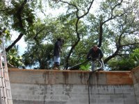

now for the block walls......waited 2 weeks before loading the block while keeping the slab wet..........form boards just removed - still laying there. Notice the plywood on the slab, I made sure that they protected that expensive finsh job on the slab.
