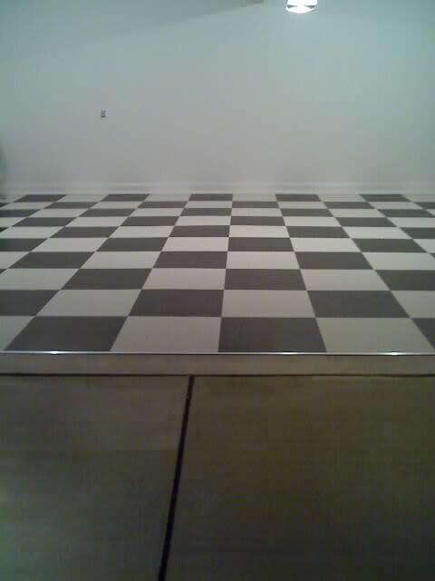

After MONTHS of debating what to use for my garage flooring, the decision to do VCT was clear. I'm on the east coast in PA and wanted something that would look great and had a shine. I found 3-4 guys that had the VCT here for over 5 years and theirs had held up great.
I thought about doing the race deck or moto floor, but once you see this VCT with the shine on it, you can't go back. The prep is super easy. No etching, just sweep the floor and clean it off.
I had epoxy in my last house and before I moved it just started to come up under the tires. There is nothing that checkerboard look.

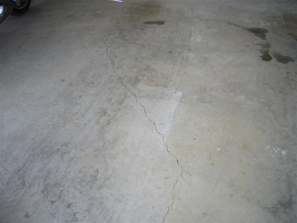

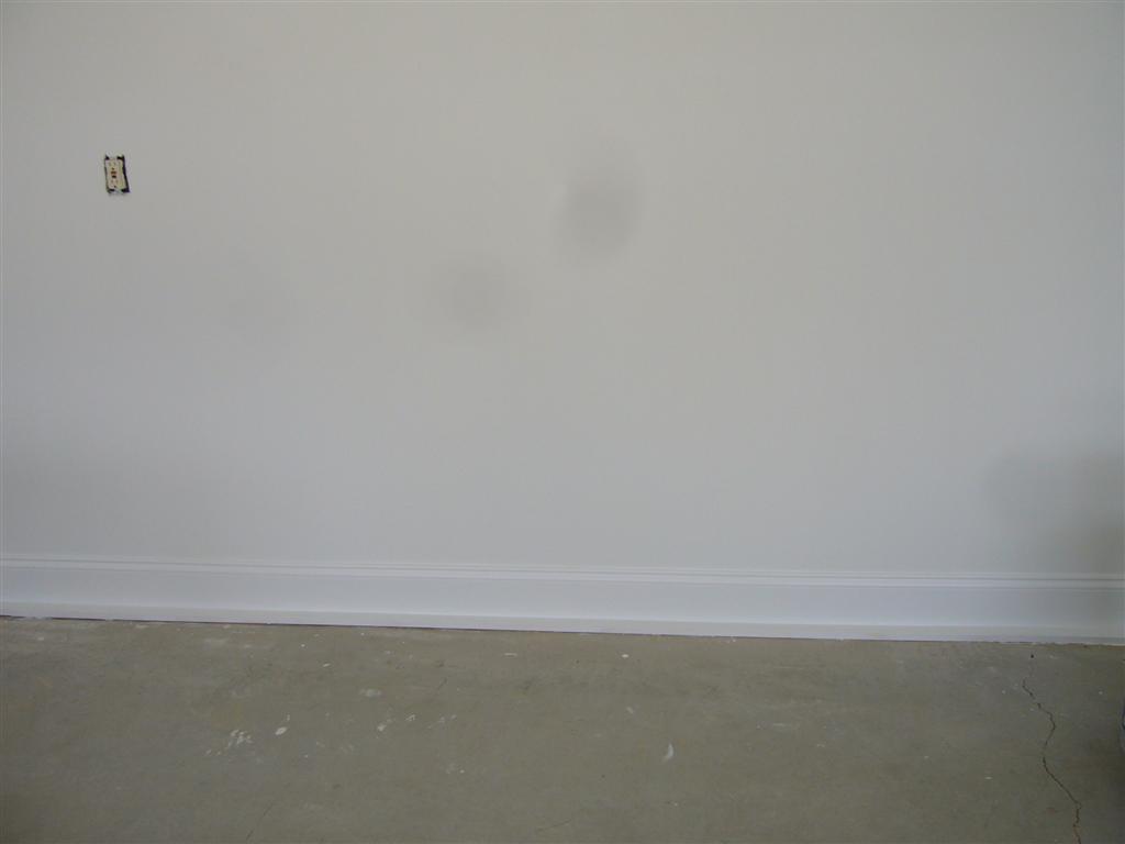

Before:
After:
Before:
After:
For any of you that want to do VCT tile, this is a great write-up to follow!
http://www.burtmanindustries.com/images/garage/vct_install.pdf - print it out and get started!

How big is your garage, and what was the total cost to put down the tile?
I'm waffling between epoxy and tile.

3 car garage, 28x21. Under $500 for everything including renting the 100 lb roller, $12. Also, link fixed.

You can read about everything I did here:
I followed the above to the T. I used the Armstrong S-750 glue. The aluminum strip was from Home depot, and is 1"x96" long, and 1/8" thick, the same thickness as the tile. It makes a nice transition.
I wanted the tile to be centered on the bigger 2 car garage door on the left, and I wanted to have a full tile when the garage door was opened in that area.
So, I started from the opening of the garage door itself, and centered it there. It just looked better to me to have a full tile when the garage door is opened. Some start at the front, and then have a half tile or smaller by the garage door. I did not want that. I also added 6" molding on the bottom with 2x10's below it to cover the cinder block. You can kneel on the tile you just layed and spead the glue in front of you. The degreaser was Proforce heavy duty concentrated degreaser, I think from Home Depot. Any will do.
***ALSO, instead of laying the tiles, 1x1, I layed them 2x2, and put 4 black tiles together, then 4 white tiles together. The BIGGER squares look nicer I think.

I put 4 white tiles to make one block, and 4 black tiles to make one block. This is the 3 car garage attached to the house. It's 28x21, which is not oversized. I'm going to put some cabinets up and a bench and that's about it.
I've seen many do the VCT with lifts and drains. These guys are all on the east coast, some with older homes and no issues. For jack stands it would be smart to maybe put extra tiles under them when you use if it's warm. The tile is easy to cut, and putting around drains wouldn't be hard. For the joints you have, I'd put the seams of the tiles on that joint, or fill the joints with concrete sealer, then you can lay the tiles wherever you want.
I also have a detached garage that's 14x48 that I'm going to store eveything else in. The adhesive I used does help stop moisture, but really won't effect these tiles anyway. It's the epoxy type floors that moisture will destroy if you have moisture. Most newer houses have a moisture barrier in the concrete for the garage.

Each tile is 1 foot by 1 foot, but I put 4 white tiles to make one block, and 4 black tiles to make one block.

If a tile ever needs replaced, yes, that is easy to do. You don't need to worry about liquids getting in. You just seal it with a "mop on" wax, after you install, and this seals it up.
You don't have to do anything special to the concrete, just have them smooth it out like normal. The prep is super easy. No etching, just clean it off with an air blower and a damp mop, that's it! The adhesive will stick to anything.
The roller, is small, and will fit in your trunk.
