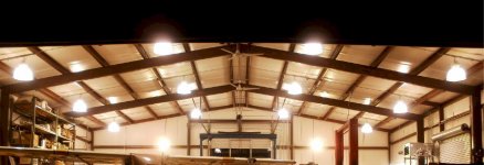

Way back in time, I installed lights in my "shop". Here is the thread.
http://www.garagejournal.com/forum/showthread.php?t=21048
What I did was install Twelve 400 watt Metal Halide lights. Three rows of four lights each. These draw 4.0 amps at 120v for a total load of 480 watts per fixture, do the math, thats 5,760 total watts. Makes you cringe when you think about that meter "spinning" (its electronic now, so it doesn't actually spin, buttttttt.........)
Here is what it looks like with everything on.
Well, while I like lots of light, there are times when I simply do not need all of that light. Up till now, I was turning on one or two rows to save power, but often, that left one end darker than I cared for.
The lights are wired on three circuits, each with one row of four on a circuit. These are MULTI-WIRE circuits, two hots fed from a double pole, common trip breaker, thru a double pole light switch, and sharing a common neutral. Thus two lights on the A side (or red wire side) and two lights on the B side (or black wire side), using split outlets, clearly marked A and B on the top and bottom of each receptacle.
The switches are installed in a five gang panel. They are P&S double pole, 30 amp switches I picked up at Home Depot on clearance for $7 each.
What I was looking for was a way to turn on just half the lights, or all of them. I started looking and found that Hubble, Cooper, and Leviton all make double pole, double throw, center off, maintained (ie they stay on, and are not momentary) switches. Looked in Grainger and found the Leviton switches, 1286-I , a 20 amp rated switch was just what I needed, but they wanted $121 each for them, and I needed three of them. Finally found three of them from an Ebay seller, Fruitridgetools, for $49.95 each and $5 shipping for all three.
After thinking about it for a while, I installed the switches so that if you push down, you turn on the A side of the circuit only, and if you raise the switch up, you turn on both sides of the circuit (this is accomplished by a couple of pigtails from two of the terminals wire nutted together).
In the top pic the lights are from right to left, plugged in, A then B then A then B. This allows me to turn on the far right lights, and the next to the left most lights. In the middle row, I reversed which socket the plugs were in, thus the first and third rows are the first and third lights, while the middle row has the second and fourth lights on.
Now I can only burn 2,880 watts if I want to, and still have decent lighting.

Wow, I thought only I was crazy enough to do that!
I wired my metal halide for 240 volts, because of the 'blistering' current requirements. Four fixtures per bay (three bays.) I measured the current on mine and it is the same as yours.
My shop also has T-8 florescent lighting too. Eight fixtures per bay (three bays.) Each bay (eight fixtures) draws just over 400 watts total. So one bay of florescent is equal to one single metal halide fixture.
At the shop entrance, I have three switches for the florescent lights, and three switches for the metal halides. And a switch (timer actually) for a sodium light outdoors. A lot of switches, but it works well. There is no reason (IMHO) to light the entire building when 90% of what I do is at the end where the shop proper is.
And, yea, I bet the power company sees a big spike in current usage when I turn everything on!
