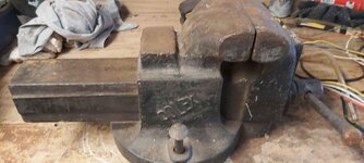

A presumably older Dolex, without the adjustment screws or prismatic slide, but with a keyed slide.
GuyM
Sep 18, 2022
1
Funny.....I'd been wanting a vice for awhile and our neighbor was having a garage sale. He had a workbench my wife thought I might want - but she said it had a vice attached. I was, like, "Well, I really don't need a workbench but I do need a vice." I'd been looking at some cheap ones. The bench and the vice were marked 50 bucks. I walked next door and my neighbor said, "Hell, you can have this thing - I just want it out of the way." I started messing around fixing small engines in my 60's - I don't know much. I also do some plumbing and on various occasions I've really needed a vice. Our neighbor commented that he looked this thing up and it was three or four hundred bucks. I was skeptical since he's pretty frugal. He just gave me the thing - this is the model. It's identical. I guess I should buy a lottery ticket, today. Woo-hoo. A really nice, heavy duty vice fell outta the sky today. I couldn't find much about the thing until I found this post.
