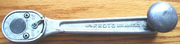

r_olson_06
Feb 12, 2012
4,168
SD
I have yet to see a know compilation of pictures of all the known wf series of Plomb. There could be more differences that we could have in a certain area of the country compared to others. A person wouldn't know that they have a more rare ratchet if that is all that were used in that area. Especially with plombtool.com going down and alloy artifacts not updating anymore. This site has alot of Plomb collectors, maybe we could find some of the missing links. I know alot of people in my area have no idea what plomb tools are and think they are junk. I can start a thread and we can fill in the gaps and unlock some of these mysteries.

I'll dig what I can out of the collection, there are WF ratchets with Proto on them also.
Here is a teaser to prime the pump...............the Plomb version resides in the collection also.

Here we have a 1/2" Proto pebble ratchet. While the Plomb pebble's seem to be quite common, the 5449 Proto pebble ratchet is the only one I've ever seen. Also, the gear diameter is smaller seems to match the WF Plomb gear diameter as opposed to the common size Proto gears. A more contemporary 5449 gear will not fit this ratchet. :dunno:
