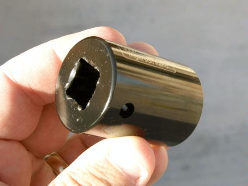

Here is a good example (found on ebay) of what I'm talking about. The sockets in the center are gloss, and smooth finished. (not paint/powdercoat), the sockets on the ends are flat, ruff and textured.
From my experience, Most of the better sockets have the ruff textured finish which I hate. I recently purchased the (Taiwan) Williams 3/8" impact socket sets and they have a ruff textured finish that is eating my gloves, and impossible to keep clean.
So I'm looking for a OK quality set with a smooth finish. All I can find is either smooth/cheap set and ruff/quality sets.

Snap-on black oxide, pure beauty...
