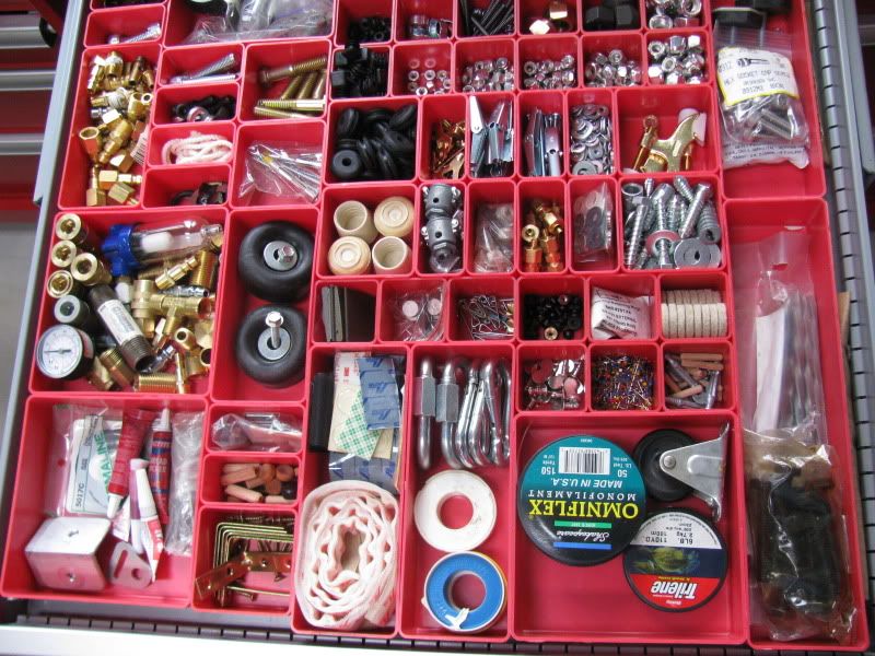

I got the boxes from Schaller Corp in MA. They have a wide range of injection-molded boxes for Lista, Vidmar and others. They have an eBay store as well, which is where I found them.
I got red this time to match the rest of the garage theme. :)
