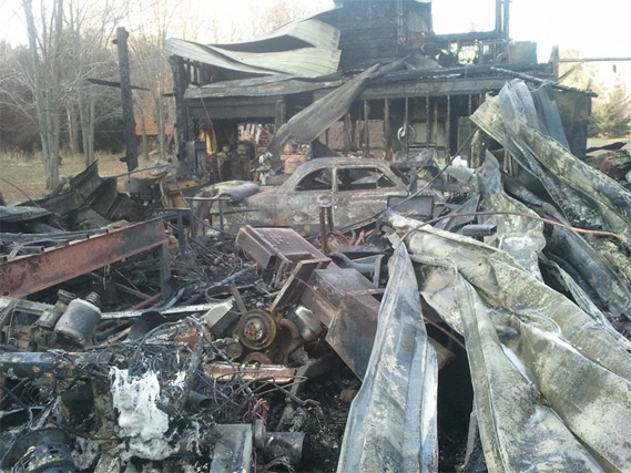

A good pal of mine recently had his shop catch fire. He's the second buddy in a year to share the same horrific tragedy. It's an awful experience that is sometimes prevent...

This fire started with an electrical short inside a wall and was accelerated by paint products.
This is, from what I see, a metal building. I see sheet metal, steel columns, steel wall girts. Electrical shorts........... Says something for EMT conduit as opposed to Romex
Also says something for having most, if not all, of your flammables in a approved/certified flammables cabinet.
I don't think a short inside of EMT will cause a fire that will spread. With Romex, in a stud wall, say, an office inside this metal building, its got fuel in the form of 2x4's right next to it, and lots of insulation, and nothing to stop it.
Wonder if one of those Arc Fault Breakers would have caught this?
I've got a flammables cabinet, it has the spray cans of paint, thinner, etc in it, but I use enough gasoline (mower, tractor, pressure washer, etc) that I keep about 20 gal in the shop. Really would like a separate building for all the yard stuff, mower, and tractor, but I don't and cannot right now.
Charles
Charles
The biggest mistake folks make with flammables cabinets-and one that I suspect you have made, is that they are rarely ever vented outside the building. Without a vent to the outside air, the flammables cabinet becomes a potential bomb as the concentration of flammables inside can exceed the lower explosion limit and the act of opening the cabinet can be the ignition source resulting in a larger fire/explosion than would have occurred had the containers not been in an enclosed cabinet.
If a single container were to have leaked, the leak might have vaporized and not been a concern. In a cabinet, it is allowed to pool in the bottom and vaporize into the closed space.
If you read the label inside an NFPA approved cabinet, there is a sticker adjacent to the 2" NPT bungs indicating that they are to be vented.

Breakers are supposed to trip at their rated amperage, but they dont always do it.
I watched a guy at work trying to find the breaker that fed a certain wire, he grounded the hot to a metal i-beam hoping to trip the breaker, it never did, it just welded the wire to the beam.
I was working on an old electric motor, had it plugged into a 20amp circuit, my clamp-on meter showed it was drawing more than 25 to 28 amps and it never tripped. It was a GFCI recpt also.
An Arc fault breaker may have tripped, but if there were paint fumes, one arc may have been all that was needed to start the fire.
Sprikler system may have been the only chance. You just never know.
That is a super good tip, and is obvious now that I think about it. I wonder how many of those cabinets have proper venting?

I was just thinking about adding some kind of fire detector in my garage after a friend of mine nearly lost his garage after a can on solvent soaked rags combusted. Lucky that his wife noticed the smoke coming out of the vents before it got to bad, just some smoke damage.
I would suggest everyone put a couple heat detectors in the shop rather than a smoke alarm. Years ago I installed a commericial smoke detector in my old garage but every time I would weld or paint the detector would alarm. It also didnt like cold and liked to sound at 3:00 AM.
Heat detectors are built to sense a sudden rise in temp and come in ratings from 135 to 200 degrees. I have a couple made by Ademco that designed to wire into an alarm panel. But I have seen stand-alone units as well that may be able to interface to an outdoor siren or strobe if your buildings not attached.

Whenever I've been doing hot work in the shop, I leave the lights on and the door unlocked when I shut down for the night.
My wife gives me all manner of Hell for it when I go out and do a fire check a coupla times during the evening before bed.
Scares me spitless and I'm gonna do everything I can to keep it from happening to me.
As soon as we collect on another job, I'm buying more fire extinguishers. Right now,, there are several, but I want there to be no more than ten feet between each extinguisher.

Yes, Good Tips...
An Good Flammables cabinets that is Vented Outside.
Lots of 15 amp circuits instead of a few 20 amp circuits. (dont overload)
The Proper sized wire to go with the correct Breaker size.
I use Conduit runs instead of Romex. (code out here)
An easily to grab Fire ext. (out in the open)
Good outlets...not those cheap Menards .99 ones.
My Garage is Detached (it can save the house if something happens)
Water in or close to your garage (most people dont have quick access)
Running equipment on the proper circuit (not Oversized breaker or undersized wire)
Outlets, switches and electrical boxes covered and sealed.
Checking to make sure that there are no natural Gas leaks or fumes.
Close any Parts washers properly and dont store gas soaked rags indoors.
Watch your welding area, hot slag can roll under objects and stay hot for a long time.
I always turn off my compressor when I am done for the night. The Motor start-up can set off an explosion if there is Fumes built up.
I would hate to see anyone loose a Shop, Garage, Home or Worse!
