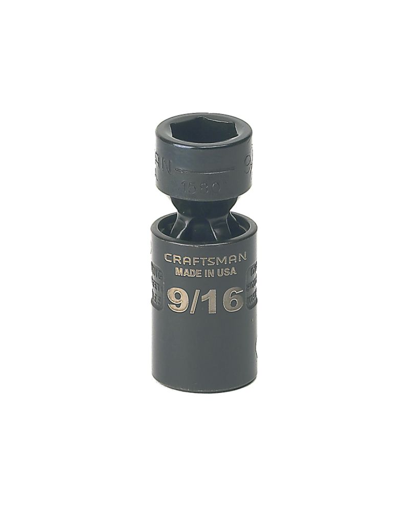

Like the title says, I'm looking for a good set of swivels, but can't swing $200-500.
Do Grey Pneumatic or Sunex make a quality pinless set?

The pinless design seems to be a danaher exclusive. That is cman/matco/armstrong.

Craftsman/Matco/Armstrong are the only brands offering pinless swivels.
On a budget the Gearwrench/Sunex/GP swivels are great. The pinless design is a nice improvement over the rest but not earth shattering.
Newer production MAC/Cornwell/Snap-On make a slightly better impact swivel than the above budget brands because they dont have the fat neck at the swivel joint so you may want to check the used prices on those sets as well.

As mentioned, this seems to be an armstrong "exclusive" (along with it's resellers) I am not sure if it is "patented" but they sure do seem to have a lock on this type design.
00915801000
00923766000-1
Here is a genius
You can't tell in the picture, but it does not have those 4 grooves. You can tell it has a fat "collar" around the middle, which likely helps secure or support the pin.
One problem I have had with proto pin-types, was not breaking, but ball-groove wear. The pin goes through a slot that allows the ball to pivot. Over time the slot grew so sloppy that it could no longer deliver the hammer blows of the impact.
I have the snap on ones which are pinned. They have not worn out yet, but I believe I would have likely been just as well, if not better, off with the armstrong/matco/cman pinless.

i've got Snap On, Matco, IR, Cman, and Grey swivel impacts. they all work about the same.
BUT...
the pinless design is nicer because it doesn't have a collar holding the pin in like some of the pinned designs do. that is the one thing i dislike most about my IR set. the collar makes the socket diameter bigger and therefore reduces the sockets ability to fit into the really small spots that i have come across.

Ok, now I'm confused. Is this pinned or pinless?
From the pictures, I can't tell a difference between the Snap-On and Craftsman.
It's a pinned style. The picture was to show how the base of the socket is quite narrow where many brands need to make it very fat in order to have enough strength.

Pinned with a shaft running through that visible channel. Snap on "laser welded" the pin to the lower body so they can get away being a little slimmer.
