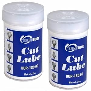

What is this lube & coolant stuff of which you speak? Well played. lol :D I keep one of those around filled with kerosene for cutting aluminum. This stuff is great also, especially for carbide burrs. Hard waxy consistency.
At home, I'm using some freaky liquid tap lube which evaporates too quickly and probably causes herpes or brain rot or some-such. (I think it's "TapFree 2", but it's been awhile since I looked at the bottle.)
When I was working on a so-called production line, we were given a product that was hard 'n' waxy, greenish color. Came in a round cardboard container, and the tool room would cut four inches off of a perhaps one-foot tube for an individual's use.
The stuff was "Do-All Tool Saver". I'd like to find a tube of the stuff, but I come up empty on Amazon and my web searches. I did buy a tube of a similar product--Blair Rotabroach stick lube. Castrol, CRC, and others also make stick lubes.
http://www.amazon.com/dp/B002YKH8L8/?tag=atomicindus08-20

Yep I like both. Good cutting oil works fine most of the time. Do-All makes good stuff. The paste is good, especially if you are drilling around electrical components or something you don't want oil getting into.
