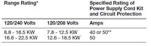

Kenmore Range. I am not sure what the difference is between the upper set of numbers and the lower set.

Nov 22, 2009
273
the diff.is wattage and operating voltage.if your range is as in the top,you can use a 40 or 50 amp ckt.bottom set says if you are useing a range that is 16.6kw to 22.5 kw you need a 50 amp ckt.
Ahh, ok. So the instructions cover multiple models and I need to check my range data plate and see what it is rated at.

Alright, here is an update. I ripped the box off the range to find the darn data plate. I now fully understand the figures given in the manual. At first, I did not realize that the manual was giving the electrical data for multiple models. The manual was basically stating that if your particular stove was was rated to use between 8.8 and 16.5kW (120/240) than you can use a 40 amp. But if your particular range was rated to draw between 16.6 and 22.5, then you must use the 50 amp protection.
Thanks oleguy for helping me understand those numbers.
Back to my data plate. My particular range draws 11.3kW. Now I am back to being confused again. Why would I need a breaker rated at 40 amps? The manual states that if I draw between 8.8 and 16.5kW, I can use a 40 or a 50 amp breaker...
P/V = A
11,300/240 = 47A
If I figured this right, at full power, this range would draw 47 amps on a circuit that is protected at 40 amps. Even if I went with a 50A breaker, that would still be under rated???

I guess they are figuring you would never have absolutely everything full blast at once for more than a very small time.
I would use a 50 amp breaker.

Range nameplate KWs are subject to demand factors.
Ranges 3.5KW up to 8.75KW are calculated at 80 percent.
Over 8.75 up to 12 KW will have a maximum demand of 8 KW.
Greater than 12KW but no more than 27KW are calculated as follows:
Each KW over 12 will add 5 percent to the 8KW demand.
Clear as mud
