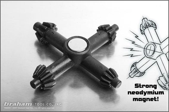

I've got so many damn chucks... and so many damn lost chuck keys. You know what...

It would nice to find one of those that work, I have a little parts box with around 10-15 of them where one key fits and the other 3 wont :sad:

On my hand drill I zip tied the chuck key to the end of the cord by the plug. It keeps me from losing the chuck key and it makes you unplug the drill to swap out bits. Safety first! On my pneumatic drill I store the chuck key chucked in the drill chuck. While in use I try like hell to not lose it! Drill press the chuck key goes in the drawer with the drill bits, one day I will put a bracket on the side of the press to hold the chuck key.
Long story short, $25 for a chuck key?!?! I think I will work hard to keep hold of the originals.

That's a great idea, but like was said, I have a drawer full of "universal" chuck keys that only work on one of the four ends.
We've always either zip tied or taped the key to the plug end of the cord as well. The one that I've lost more than once over the years is the drill press. Hence the drawer full. . . If I could even get one of the ends on that magnetic one to work, I'd buy it and stick it to the side and be done with it.

Is that so you can figure out the correct key end on the fourth try each time?
I have the key attached to the cord on my hand drills.
I put a permanent magnet on the side of my drill press...

I think the prior comments pretty much sum things up. There's nothing new about the concept of a multiple-head chuck key. Usually two of the heads don't seem to fit anything, and even with a magnet, it can still get lost. Also for the $25.95 price tag, I'm a lot more motivated to keep the original keys that come with my power tools. (I haven't lost one yet.) On the plus side, at least the thing is made in the USA.

For the drill press, I find a magnetic parts tray works well. Slap it on the belt cover and keep the key in it. It also makes a convenient place for loose drill bits if you're swapping back and forth between sizes.

On my DP I welded some folded link chain to the key, and bolted the other end to the motor bracket. For corded hand drills I use the tied to the cord end technique.
I like the mag tool tray idea for loose drills...
Hmmm strong magnets and a small drill index for common sizes.... Better still!
39,391
The DP chuck key on a chain:
And the 30 second fix for keeping the drills handy (which took 30 min to get a pic of trying to get a working battery for the dang camera...): :dunno:

On my drill press, and lathe, I screwed a retractable keychain to a super magnet, and put the chuck key on the end of the chain. The super magnet is so strong, it's like the keychain spool is bolted to the machines.
I can grab the key, use it, and when it let go, it flies right back home.

Amazon has these for less. Lisel brand I think? I've been looking for some that aren't made out of pot metal!

Rare earth magnets are great things...you do need to place them VERY carefully in a work environment or you will find a 6" ball of shavings, cotter pins, and missing bits.
Also they need to be placed so their bond to storage location is stronger than their bond to tool being stored, or as your key approaches the work it will **** up all those shavings.

Adding to what Sifu Landcaster says :D there's and easy solution to the shavings stuck to the magnet. You can use a plastic shopping bag or a ziplock or sandwich baggy over the magnet. When shavings have accumulated you pull the plastic away and replace it. I learned this after struggling with the issues years ago and a buddy showed me what his father taught him. I've used the trick many times when using a magnet to pick up dropped items into places with metal dust or shavings.
