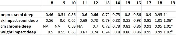

i just went and measured two sets of chrome (nepros semi deep & craftsman deep) and two sets of impact (sk semi deep & wright deep). here are the results - the size socket measured across the top, 1 brand/set per row, and the diameter in fractions of an inch (sorry, US micrometer was at hand):
8 9 10 11 12 13 14 15 16 17 18 19
nep .46 .51 .56 .60 .66 .72 .75 .80 .86 .90 .95 1"
sk .56 .60 .65 .69 .73 .79 .88 .88 .93 .95 1.01 1.06"
cm NA NA .59 NA .70 .72 .78 .81 .86 .93 .95 1.01"
wrt .5 .55 .63 .67 .74 .74 .80 .86 .86 .95 .99 1.02"
while it is clear the impact sockets are larger in diameter, the wrights (a higher quality socket than the SK IMO) are all less than a tenth of an inch bigger, and in most cases are 5 hundredths or less larger.
how many spaces for a socket are clearanced to less than half a tenth? none that i've found...
