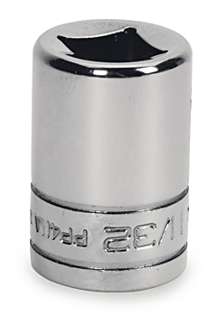

Hi, trying to find a 9/16" female/internal 4-point pipe plug socket in 3/8" drive or 1/2" drive. A few searches showed this type of socket on a number of sites, but not in the 9/16" size.
Looks like this (this is a Snap-on Socket, Socket, Pipe Plug, Internal, 11/32", Stock#: PP411A) But who has this in 9/16"? Thanks!
I need it for my borg warner t-20 skid steer transmission. A 9/16" open end wrench works fine but takes too long to get at the plugs. I could use a 12pt socket of some size I guess but I'd like a 4pt in the desired size. The t-20 skid steer level needs to be checked often because with age they tend to leak ATF out and then the drums and bands shred like crazy and a rebuilt alone is like $1300.

A 12 pt would not work, but an 8pt would. The 8pt is going to be the cheapest and easiest option for you. Get an 8pt socket in the drive flavor of your choosing.

ah ok, thanks, 8pt should work. The plugs aren't super tight. I saw 4pt in all kinds of sizes, but not in 9/16" :(
So maybe this one? Socket, Double Square, 9/16", 8-Point Stock#: SW418
excellent..even mcmaster.com has the 9/16" 8 point socket, probably would be armstrong or proto....hm...I need more air quick connects anyway...

That's what i would try. :thumbup:

You also might try a 5/8" 12 point if you have one already. ;)
You mean everyone doesn't have full sets of 8pt in the three popular drive sizes? Even you? .....................I do, but none of them are SO...........................Guess what? ...My Bonney 8pts work just great! :spit:
