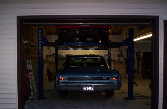

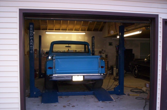

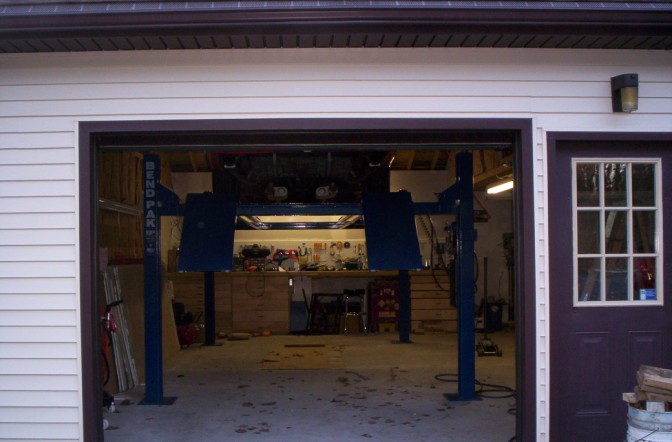

Ok guys, many of you were a big help to me so I want to do my part and give back by giving my personal story on this HD-9 adventure.

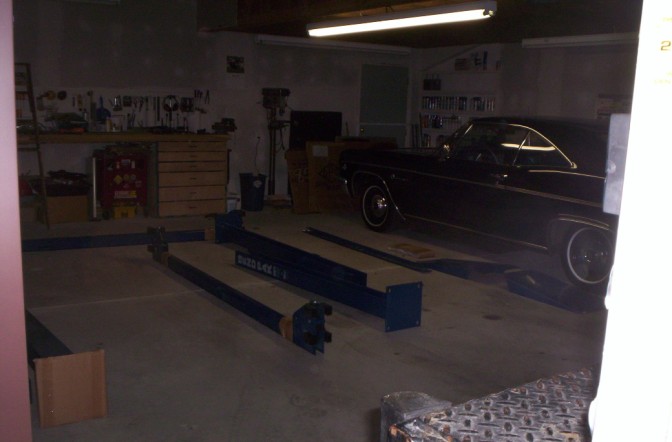

Major complaint/problem: Power runway end beam windows were not positioned correctly. Minor complaint would be the instructions could be better. First I'll start with the assembly, then the transportation of it. Ok, here goes:
End of the power runway that had the single pulley's did not go all the way down onto end beam so holes did not line up to even put the bolts in. Also due to this, the single pulleys would not turn as the window openings were not aligned properly causing them to bind up. A "BFH" straightened out the end of the runway which helped but a grinder was also needed to remove two humps in the top of the end beam where the runway sits on. Looks like it swelled up from the welding process. Once these "repairs" were done, the runway sat down properly allowing the pulley's to turn freely.
Now for the worst part. The other end of the power runway with the double pulleys was so far out of alignment that before even putting the runway into place, the pulleys would not turn more than 2 inches! This is something that should have been very evident when those pulleys were installed by Bend Pak. It was however left go for the customer to deal with. The fix was to grind about 1/8 inch of metal from the window opening so the pulleys could turn. This only solved part of the problem. Once the runway was set into place on the end beam, those window openings did not align and were off by more than 3/16" as well as the bolt holes being way off. Using the "BGH" again and grinding ALOT of metal out of the window slots was needed to fix this. Needless to say, I was not happy having to do any of this. Poor quality control for sure. Maybe this is where the made in China part comes into play???
Next, the non power side runway needed to have a hole on each side drilled out as well. The holes were off by about 1/8" not allowing the bolt to go through.
Lastly, I feel the instructions could have been better. Some things were just too vague for a first time installer. And the tool list in the manual, I could add about 20 more tools to that list!!!
Now that this 2 day hellish assembly nightmare is over, I am pleased with the way it operates and the overall feel of it. It's rugged and I feel it is safe. As long as the cylinder, pump and motor are of good quality, it should last for a long time. (knock on wood)
As for putting it together in 4-5 hours? Wasn't happening for me. I did work mainly alone so that didn't help the speed process but this was a JOB! Day one I worked on it from 10:30AM to 6 PM. Day 2, I worked from about 10 AM until I finally raised the lift under it's own power at about 4:30 PM. I still want to fine tune the locks/cables but that' today's job.

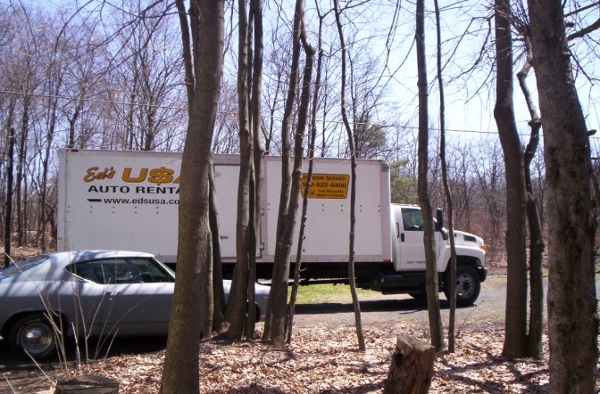

Now for the "getting the lift home" part! Just about everything that could have gone wrong did! First, I ordered this from Northern tool and specifically asked if it could be shipped with Conway trucking as there is a terminal less than 2 miles from me. They said SURE, no problem! Because of this, I requested it be shipped to that location. Well, there sure was a problem. A few days later, Bend pak sends me an e-mail letting me know the lift was shipped by Yellow trucking! Uh oh! BIG RED FLAG TIME!
First thing I did was go to Conway trucking and explain the situtation. Thinking they wouldn't be too happy about having a competitor dropping something off at their place for me, I checked with them and they were more than happy to help me. (so they said!) EVen offered to allow me to unpack it on the dock to load it into 2 pickup trucks and also offered to help load
it if needed. Took my phone number and asked if it was ok for them to sign for it. (which I agreed to)
A few days later, Conway trucking calls me telling me that there is a truck here with the lift and they cannot accept it! WHAT??? I even got the manager on the phone and he said they would not accept it for liability reasons. Afraid I'd sue if it got damaged. Bull! They just realized they weren't going to get any $$$'s out of the deal. I offered to sign a paper or
similar to release them of any responsiblity but they outright refused.
Conway is the biggest part of the problem here. If they would not have acted like they would help me, I could have made other arrangments ahead of time. I should go find the jerk I spoke to in person that day and have a serious "discussion" with him!
So now I have a trucker waiting for me to somehow get this damn thing off of his truck! (and he's not waiting much longer!) I frantically get on the phone to find a rollback to go winch it off and bring it to my house. HA! Try getting one of them to help you in a hurry. The first one said he was busy working on a car and couldn't do it. (note, he's 5 minutes away from this place and only 2 miles to deliver it) I then try location #2 which is also 5 minutes away. He says there are 2 other tow jobs he promised that he still had to do so wouldn't help me. Location #3: This persons garage is also only 5 minutes away from the trucker also but unfortunetly, he was out on a call and couldn't get back for an hour! I should also point out that I had gotten estimates from location #1 and #2 so both of them knew I might be needing help with this project soon.
That was it, I was out of options. I called the trucker back and told him to take it back to his dock in Allentown, Pa which is 55 miles from me and I'd figure a way to come get it the next day.
Next day was a scramble to find a rental truck. Thought I'd rent a 16' cube van (moving van) but when I called the trucking company, they said it would not work as they are not "loading dock height". Being almost 14' long, they could not pick this up from and end to set it in a truck, it had to be slid in. So my last remaining option was to find a "dock height" truck.
I finally did. Bad thing is it was 24' not including the front of the truck! (a 2006 Chevy 6500 series) LOL I never drove a big truck like this but kept my optimism and looked upon it as a "road trip adventure". (It was fun and I didn't even put a scratch on it!) lol
It ended up costing me just over $200 dollars to get this lift home with rental cost and refilling the Mamoth beast! It got 7 miles to the gallon! :( Cost me $58 dollars in gas to go 121 miles!
Looking back now, the road trip was a blast but the overall experience was 3 days of torture. I'm so sore and stiff right now I could barely get up this morning.

Ok, here's some pics: (click links for larger pics)
http://www.348-409.com/lift/100_4898.jpg
http://www.348-409.com/lift/100_4903.jpg
http://www.348-409.com/lift/100_4909.jpg
http://www.348-409.com/lift/100_4915.jpg
http://www.348-409.com/lift/100_4916.jpg
http://www.348-409.com/lift/100_4919.jpg
http://www.348-409.com/lift/100_4921.jpg

When i assembled my HD-9ST a few years ago, everything fit perfect.No grinding or modifing.

I bought my life a little over a year ago, and every part of it fit like a custom fitted glove. It didn't take me more than 5 hours from start to finish. I did have one issue getting the large nut onto the cylinder, but that was resolved quickly once I got a good impact wrench. I will agree that the instructions do leave something to be desired, but overall, they were good enough to know how to put the lift together. Sorry to hear that you had to do some grinding, drilling, and fitting. If you need to do any paint touch up, I found that the Ford engine blue is just about as good a match as you could find.

I contacted Bend Pak through their website a few days ago just to let them know of the defects I found with mine so they could check any others they have going out and I got a call today from them.
They offered me one of their sliding jacks for $500 for my inconvenience but since I'm only a hobbiest and $500 is a bit too much to spend in my life right now, I declined their offer so they are sending me a free floor jack instead. :bounce: That sure is nice of them!
I certainly didn't expect such a generous gesture. They obviously care about their customers. :thumbup:
BTW, the lift is working GREAT! I did 5 oil changes on it already!

I hope you like the floor jack. We’re purposely sending you the aluminum racing jack. Should be easier to get off the truck. :lol_hitti
We do care about customer service and look at situations like this as an opportunity to shine.
Sorry about the holes not lining up. Many BP owners have not experienced this problem as their lifts did not have the added support straps welded to their cross tubes. The straps are 1/4" thick and added to the top and bottom of the cross tubes for added strength. Our engineers obviously miscalculated the differences resulting in the miscues.
The straps although not necessary for structural safety, were added to reduce “bowing” under full load. Our HD-9 series lift is now being sold as an alignment lift overseas (model HD-9A) and is equipped with turn plates and rear slip plates. It is crucial to exceed normal material yield parameters on alignment lifts due their application. Runways and cross tubes must remain as close to perfect level as possible under full load.

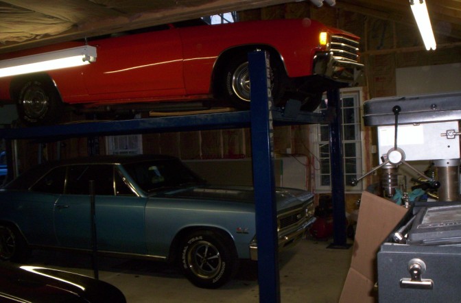

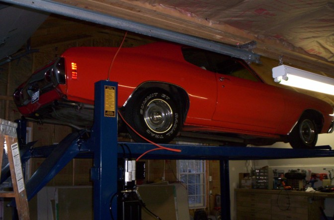

Thank you Jeff! I appreciate the reply. :)
I'm loving this lift and believe me, everyone that drives by IS looking in! :bounce:
Being able to work on my own 7 antiques alot easier is awesome but in addition, I am able to help out my family with their cars too. I changed my daughters oil yesterday saving her money already. (Dad's labor is free)
I used to say my welder was my favorite tool but I have to change that now to my 4 post lift! :bounce:
To anyone that can afford to buy one and has the room, I strongly recommend getting one ASAP. I only wish I could have gotten one many years ago. The quality of your work (restorations in my case) will greatly improve.
Oh yeh, don't let my nightmarish story throw you off, I have naturally bad luck and probably got the one and only that had the defects. LOL
Ovilla: just noticed your question. I did go with the 220 pump. Won't be getting the casters as my garage was built specifically for this lift to go in one spot. I may move it about 6 inches to one side yet but then, that's where it will stay. I wasn't sure about bolting it down but so far, it feels just fine unbolted. I have radiant tubes in the floor so may just leave it as is. (remember my luck? I'd for sure hit a tube if I tried!) :lol_hitti
I've already built one jack platform for the front that will slide in the inner tracks and will be making another for the rear. Once I add 4 small jacks, I'll be all set for almost any job I need to do. I could have bought these but I like fabricating my own things when I can.

Not sure if you had read my post from several years ago, but I did a write up on the Bend Pak HD-9's I bought too.
http://www.garagejournal.com/forum/showthread.php?t=636&highlight=bend+pak
For a few reasons I was never able to install the 2nd lift right away, but eventually did in December 2006. I posted about that one on a car forum.
http://www.dodgecharger.com/forum/index.php/topic,22425.0.html
The 1st one has been up since February of 2005 & has never given me any trouble. Installing it was slow going, but relatively trouble free. The 2nd one went much faster, but I encountered a snag with the cables & where they route inside the cross support. I'll ressurrect my thread & add to it so others can read it.
I like my lifts & would recommend them as well. :thumbup:
Pics look great... nice open garage. I can see you have a lot of use for those types of lifts.
