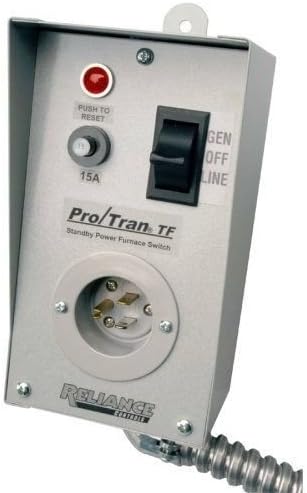

Because NEC 400.8 says what Flex Cord cannot be used for and "As a substitute for the fixed wiring of a structure" is one of the reasons.
You could install a Double pole, double throw switch rated for the current involved (usually not a lot if just a gas furnace with blower and control circuits) and route the hot and neutral of the house thru it to the furnace and have a suitable pigtail cord from the box connected to the other side of the switch. This way, throwing the switch takes the POCO/house wiring off the furnace and allows the generator to supply the furnace, throwing it the other way removes the genny and puts the house back to supplying the furnace. No way the two power sources can both be applied at once and has the house wiring properly hardwired to the furnace (thru the switch).
Charles
Charles
What you described is almost exactly what my mom and dad have to power their furnace with a generator.
Same switch setup and it has a center off position, but, instead of a cord dangling out they have an inlet wired in and placed by the cellar window.
An inlet is the exact opposite of an outlet. ;) :lol_hitti
Just run a cord from the generator to the inlet, throw the switch to the other side and the house goes warm. Safely.
Power comes back, throw the switch back agin, unplug the cord. Simple and safe.

Wow, kinda pricey, but that would do the job. Never seen it in a HD before but they have lots of items that don't make it to the stores, and not all stores have the same stuff. Was in one today about 70 miles away from the house, and it had quite a few items I don't find in the store 15 mi from the house. Different store "buyers", which are the people in cubicles responsible for what each store stocks. Each store has several "buyers" who only work one or two stores.
A 20 amp DPDT switch is about $50 (I bought three of them from Fruitridgetools.com last year) (and you need the DP to transfer both the neutral and the hot of the 120v) and a decent cord and plug or the flanged, recessed inlet plug like the Reliance box uses, is another $20, then add a box to mount all of this in, faceplate, etc, you are not far from the price of the Reliance box.

Extension cord and
Reliance Control TF151W Generator-to-Furnace Transfer Switch
