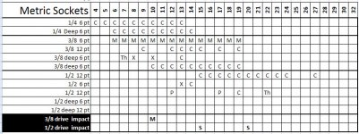

I've been filling in holes for years, mostly from Yard sales and Flea Markets. This is a stripped down version I use in my inventory, showing just the basic sizes (No dupes). I used to carry the equivalent of this on a 3 x 5 card in my wallet long before computers and Excel. These days I just use Excel. The different letters represent different brands. (Apologies in advance to the OCD types...)
C'mon now, don't be stingy. Share the ACTUAL Excel file so the rest of us can make our own :bounce:
Wow. That's more organized that I will ever be. :bowdown:
Easiest way would be a Google Spreadsheet I'd imagine.
Yeah, except I don't have a Google account I'm willing to broadcast to the world. One person has asked for (and received) a copy of that Excel worksheet; PM me your email and I can forward it to you.

I have a similar list to Outlaw's in Excel. This reminds me that I need to make some updates! If I were to do it again, I would probably make it in the Google version of Excel. I like the use of letters to denote the brands so I will probably update my list in that way.
The one additional I have on mine is that I made the borders of the cells red if the socket size is on the Hansen trays. Even though the Hansen trays have some odd sizes, they still provide a reasonably good range of normal sockets sizes for each drive size.
My list also has several styles of wrenches and specialty sockets (swivels, crow, etc.) It is all good to have.
