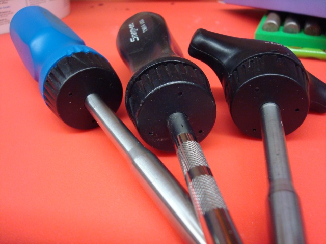

There are situations when having knurling on the handle would be beneficial, though I guess you could put something on there to add grip.

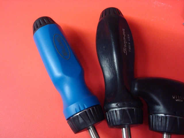

They are the same quality and the same ratchet mechanism. Same stainless steel shank. What's nicer about the Williams though is that the seal for the cap doesn't poke at you like the Snap-on unit does.

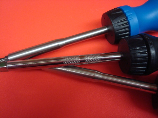

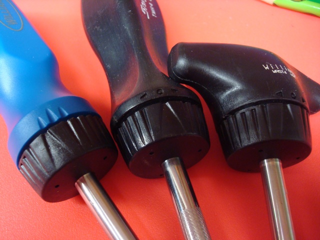

Here's a quick side by side comparo:
Snappy Ratcheting Driver with comparable Williams and Williams T-Handle. The ratcheting mechanisms are identical in your hand and the pictures easily show that there's a good chance that some of the parts on the Williams are the same parts as on the SO. The shank on the SO is polished where as the Williams is more of a brushed finish. The shank has the knurl (as others have stated) and the Williams does not. Obviously my SO is a 1/4" ratchet so the shank is different in that regard for obvious reasons.

The knurled shanks add cost to manufacturing. Williams seeks to minimize the production cost for industrial use.
