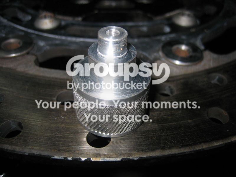

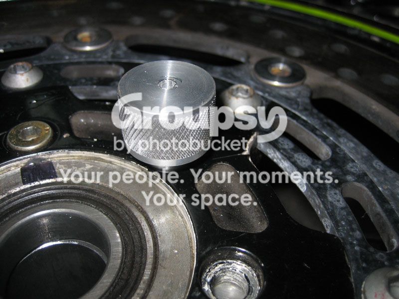

Let’s go to the front wheel first. Last we left off, the bearings and spacers were all finished and the wheel centered perfectly between the forks. The only remaining issue was rotors. The R1 rotors are 298mm diameter, the Ducatis are 320. The Ducati rotors are also 4mm farther apart than the R1. By machining the calipers where they sit on the fork legs I can accommodate the smaller rotor. To space the R1 rotors to the correct distance while utilizing the Marchesini hub plates, there are two options. Space the rotors out, or space the plates out. By spacing the plates out, the extra mass of the spacers is closer to the hub having a smaller effect on the wheel inertia. To do this two 2mm thick 64mm ID and 100mm OD spacers are needed. I used 6061 for this for the sole reason that I had a piece of stock in 4” diameter sitting next to the lathe. I forgot to take in process pics, but here is a photo of the finished parts.
This is how they fit on the wheel to space the rotor hub plates out 2mm.
I still need to drill the 6 thru-holes on each piece.

The rotor spacers are the last component for the front wheel. Each disk will need 6 holes so the mounting bolts can pass through. The disk is only 2mm thick and I couldn’t come up with a great way to hold it down on the mill without causing distortion. The method I used to layout and drill the holes was to put the spacers on the rim and the rotor plates over it. I made up a drilling guide to center in the rotor plate and allow a small pilot drill to pass through and drill the spacers. I made one hole to size from the pilot hole, then bolted everything to the wheel and finished the pilots for the remaining 5 holes. Here’s a shot of 5 holes drilled to size and the 6th with a pilot hole. Repeat for the other side and the front wheel is finished and ready to mount up.
