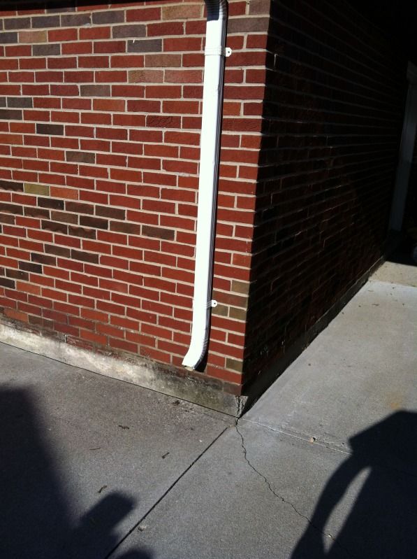

Hi everyone,
I'm getting ready to build a gate to go across my driveway. I picked up two surface bolt 4x4 post holders. Pictured below.
My plan is to drill down and put some all thread down in each hole and use some epoxy that is used for concrete and then bolt the mounts down.
Question is how long should my all treads be? The posts will be about 5-6 feet tall, so I can level it up with my existing fencing

They make a stud for this purpose and it is located near the bracket you show and the epoxy that is used for it. They are galvanized and ~5" long. I will second the concern Jake has in the bracket/post failing if you have a large swinging gate hung on the post. If the end of the gate is supported with a wheel or the gate is a sliding gate then not so much worry.

That will not hold up for a gate. Cut a hole in the concrete and dig a hole for the post and concrete the post in.

Does it make a difference that the gate door will be about 4 feet wide?
I'm also using 2 adjust a gate setups like in the below picture

It doesn't matter how you build the gate. You will have all the weight hanging from a moment arm installed in a very short socket. After the post shrinks nothing will be tight. The post needs to be in the ground to overcome the leverage applied by the gate. The posts you show in the picture are anchored several ways plus at the top.

Thanks for the info guys, was hoping to get away from having to cut up my drive way and then having to come back and fill them.

how thick is your concrete? If you've got a 4" slab, bolting into the concrete might not work well. If you've got a thicker section then it's do able. They make bolts and epoxy for that reason: Dewydag. But damage to the concrete is possible if the slab is too thin. I agree that shrinkage may be a problem but I dissagree that It has to be embeded.

I'll post a pic of the drive way later. the one post I can connect to an existing pos for support, but the other will be right up beside my house which is brick.

That bracket for sure wont hold up to almost any gate.
To set a post rent a stand up style core drill and get a bit with enough clearance (~2" on each side should be plenty) around the post to leave room to fill and tamp the post in place in concrete, (Quicrete RED bag works good for posts)
After you punch through the concrete with the core drill use a post hole digger to get the rest of the way BELOW the frost line. I like a minimum of 18" or more for a small gate, large ones 3' min. regardless of frost line if it's less.
Set your post, plumb, it fill the hole with concrete to the bottom of the driveway pour, then use a non shrink grout (hydraulic cement) like Rockite, Emacogrip, or Sonopost to come up to flush with the surface.

anchoring into 4" of concrete works for free standing 2 post automotive lifts...the concrete will not be the weak link.
Another option is to have a 4x4 (or similar) post fabricated out of mild steel with a bottom plate welded on with the 4 hole pattern. If you anchor this to the concrete (a reasonable distance from the edge of the concrete to the first anchor....say 8 to 12"), it should support the gate well. You can paint the steel brown to match the stain.

Jake has a viable option but the base plate would have to be fairly large, say 8x8x1/2 for a 4" post to overcome the moment.
