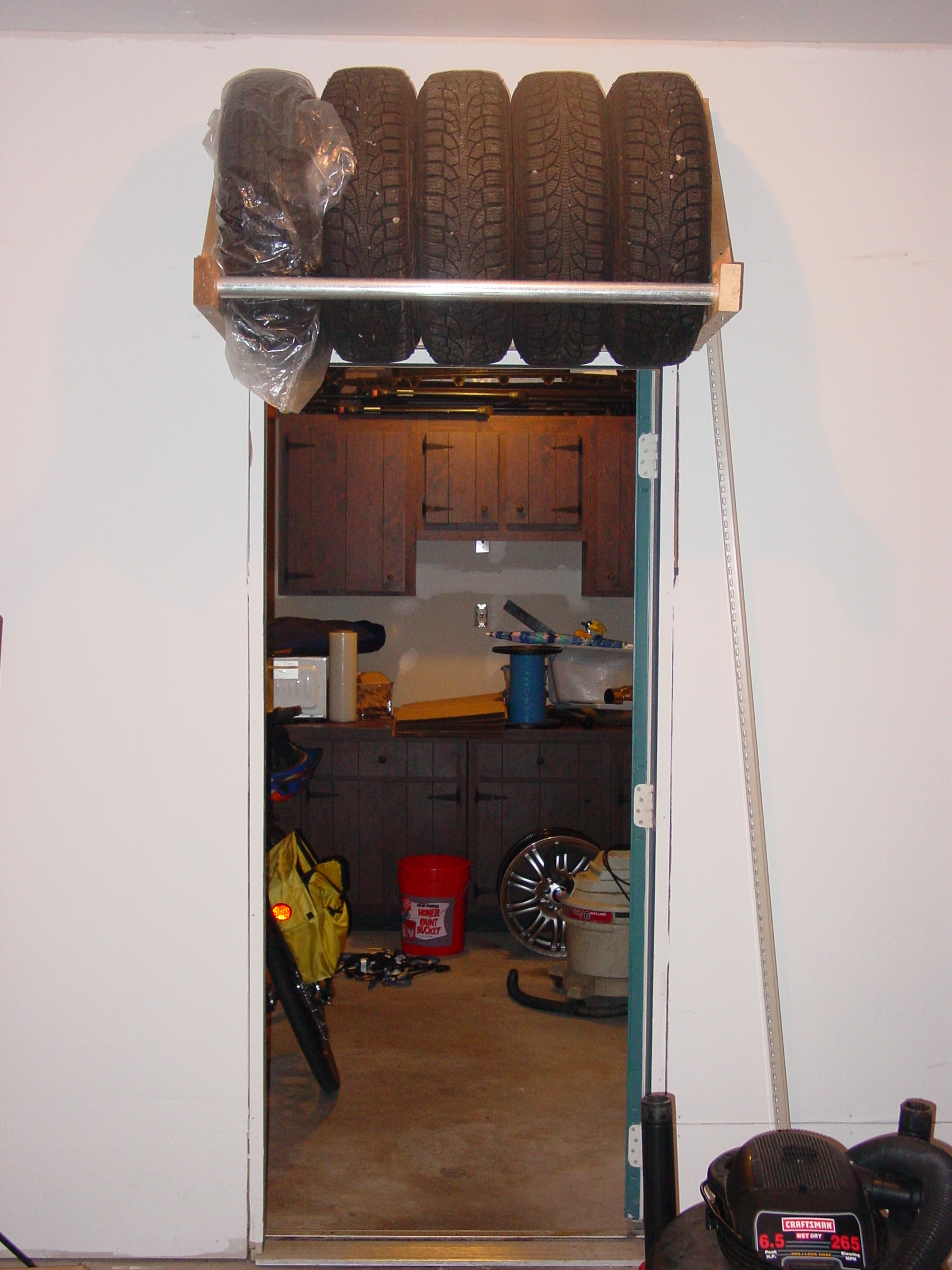

This is my solution. Its all 2x4's, and a single piece of 1 3/4 fence post top rail. Its 38" wide inside, enough for my fiance's snowtires, and a spare. Even with all 4 wheels/tires, and the spare, I can hang from it (I'm 230lbs). If you want, I can detail the construction some, but you can see most of it. Its all screwed construction.

G1K,
Any of those tires have wheels in them?
How heavy of chain (diameter) did you use? Probably just a camera trick, but it looks a little light.
Only one of the sets of tires have rims, the rest are just the tires. The picture shows the right side of the right rack slopes down, not an illusion, it does slope. the largest diameter tires fit in that section. The chain is a bit on the light side, but it's been holding strong for a year or so.
I would love to have the dimensions and any other details you can add!
