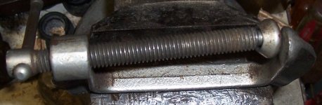

This first one is pretty simple. It’s a sprung C clamp.
Pretty obvious what is wrong but I straighten these routinely. I’ve never had one break either in the straightening process or in use. (I have had a couple of really cheap clamps I got from my dad an age ago, that were brittle metal and simply snapped in use. Smaller clamps 2” or less…)
First step, get it into the vise for initial straightening. Getting it in like this insures the bent arm gets the pressure.
This is after the straightening and the pressure was released other than to keep it from falling out of the vise:

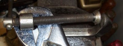

It didn’t come out completely straight and I often see them bent like this.
Clamp it sideways and a 12” crescent come to the rescue:
And here it is ready for use again and added to the collection as my ninety fifth C clamp!:
