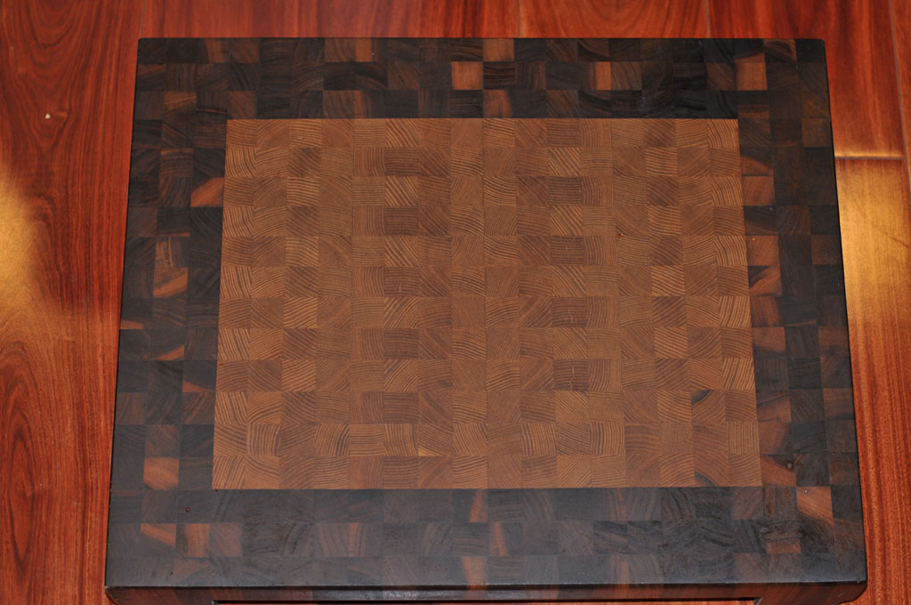

My neighbor is a retired finsih carpenter and is always building something cool in his shop. He has a large pastic tub in which he tosses the "shorts", or "scraps" where I come from... :lol2:
I asked him if I could take them to make a cutting board out of and he gladly said yes... So this is what I made....
I used my 10"table saw and cut the sections into 2 " strips. Next I moved the Blade(fine finsh) to about 1/8" from the fence. This let me run all the edges and clean up the random pieces as best I could. Some of the pieces were not 90deg. to start with, and I honestly couldnt figure out exactly how to correct that. In my rookieness I thought that simply running the 4 sides on the equally measured blade setting would correct that but instead it just cuts an equal copy of the angle you started with. :dunno:
I suppose you could use a carpenters square, mark a new 90 and cut the line, but I didnt think of that at the time so i decided to wing it. :lol:
Anyway, i put the "puzzle" together and got out the glue and clamps.
In the future I will use 2 clamps on the top and 1 clamp on the bottom so it pulls force equally. Instead as you can see I tried to put all three on top and the result was terrible. It caused a slight bow in the surface that I would later have to get corect with the sander.
Dry and pretty disappointing...
I used a square and marked off the sides to be cutt at the widest points possible.
Hope was slightly lifted at this point..slighty...
Holy Sanding! I used the 36grit 3x21 belt to really get after all the unevenness. I actually think I might be winning!
***funny side story*** I went to the store with the ingenious idea that "I'll buy a planer and that will fix this thing right up" ..:lol: I had no idea a planer was so much money! Needless to say, I did not buy a planer and went back to sanding...
So my slacker attempt at leveling all the sides went ok at best. I had some pretty big gaps but my shopmate Jarrid offered a cool fix. Mixing the saw dust from the board with the woodglue created homemade fast dry wood filler.. I took advantage of this technique!
so that dried and I resanded it down. I then had to do a second run of filler to get the final seams... It added another hour but it was totally worth it. Since I was working on several things it seemed silly to rush it.
anyway, after sanding up to 80grit
I used the palm sander and rolled the edges. I like this look, one day Im gonna try to make one with perfect edges and alignment but for my first one this is an awesome technique to bleand in my amatureness. ;)
After sanding up to 220grit
side one
side two
I used a food grade Butcher block oil and sealer.
Then waited 12 hours or so and wet sanded up 400grit.
Another coat was applied and it also was allowed to dry for about 6 hours.
Then I wet sanded it up to 2000grit...
Turned out way better than it looked like it would in the beginning, and its smooth as glass.
How it looks with some of the knives I made this weekend. I love how the handles match colors in the board.
So lessons learned to save you the trouble -
1. - 90deg doesnt come from measuring the blade distance really carefully:headshake
2. - Planers are really expensive
3 - Use your clamps in opposition to avoid the curve
4 - Just keep sanding ...its bound to turn into something:lol2:
5 - If I can make it out of wood anyone can...
6. - Use the endgrain of the wood instead of the long grain for a harder, longer lasting cutting surface.
Thanks for checking it out!

Looks excellent. Good thing you didn't buy a planer. That vertical grain is hell on planer knives. It'll want to jump and chatter. Ruins knives, and tears all sorts of chips out.

ahh...i wish.. almost every scrap piece is less than 3" long so the long grain, which is whats needed to make the handles out of, isnt quite long enough. The only way to cut it long enough is to have the grains running up and down through the handles and Im concerned that it wont be strong enough in that direction...
That wood is expensive so its a double bummer... but hey, in another month there will be enough scrap to make another board. So at least theres that.
Any of you wood guys have an opinion on the above theroy..Am I correct that the wood wont have enough strength to serve as a kinfe handle. I just feel like it would break easy..???
The only planer big enough to fit that board was a $600 dewalt and thats not even close to an option for a secondary hobbie like this.. but thanks for the info about the end grain being to course. makes good sense...
The 3x21 belt sander actually did a pretty efficient job at bringing it down. If I can get better at cutting the blocks even in the first place it should be even easier next time...

I believe you're right about grain direction and strength but ..
just do stick tangs with segmented handles.
I save all scraps of materials. Nickel silver , copper, aluminum,stainless and brass sheet stock can be used along with fiber spacer material in between regular handle material for highlights. I've used woods with the grain running perpendicular to the tang , but they were pieces 3/8 " or less thick.
Now gluing all that stack together can be a real test of patience and dexterity befor the 5 minute epoxy kicks!

Turned out nice. Glad the planer was so expensive, 'cause you don't want to plane (power planer) wood across the grain (end grain). If, as I imagine, the pieces you started with were short, it wouldn't have helped because most planers want about 10+ inches or so.
By hand at that point, a hand plane would be the tool of choice.
Wood can be squared on a table saw, with some fore thought and planning.

That's interesting you mentioned this. My neighbor was just telling me this evening that he would teach me to use the table saw to square things up. I went over to ask about a craigslist jointer I found but he basicly blew off the idea. Said that you dont need more than a table saw, router jig, and drill press to build anythig...
If you saw the stuff he makes his argument is pretty convincing...

You can use the tablesaw. It is a little dangerous, but is possible for smaller pieces.
To level a really bad board, the best way is to make a jig that uses a router.

Its all natural coloring. The exotic stuff doesn't need stain. The Finishing I use now days is watco butcher block oil and sealer.
The blacksmithing journal linked in my signature has some woodwork in the most recent update post and about a month back. Learning to tune up the saws, use the right blades, and most importantly...."the Aggiemethod" have improved the craftsmanship slightly above this thing. Lol
in truth I've made alot nicer boards since then but we still have this one on the counter and it gets used everyday. There's beauty in its imperfections....
