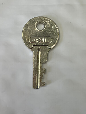

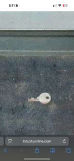

Hey dose anyone know what key fits these boxes I can only find blurry images I have a 50s version of this 7 drawer trying to identify the key.

Have a similar larger box. My lock is broken, but looks like it only locks the buckle, not the lid mechanically as on modern boxes. No identifying info on my key. If there was any, its worn off now. Don't know if all keys were the same.

These are Excelsior locks they have keys available usually a 3 digit on the front face of the lock 4XX or possibly 4 digit KYxx
