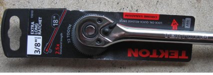

Here some pics of the TEKTON ratchet I took with a Snap On FLL80 next to it for a reference.

Nice pics, let us know how it works for you, I have the Ez red comfort grip set and find the mechanism drag extremely disappointing.

Thanks. I plan to take it work and use it there for a few weeks to put it through it's paces. Primarily bought it for my home box as I was tired of taking home my Snap On FLL80 on occasion.
The drag on mine was actually pretty smooth as received even though it was dry and void of lube. I lubed it with some DuPont Krytox synthetic light grease and now it is just as smooth as the Snap On Dual 80 mechanism.
I know the COO Nazi's will not like it but I have to say finish of this ratchet new is way nicer than the Snap On. The knurling on the handle is also nice and crisp and feels good in the hand.

Mechanism looks similar to the Kobalt 3/8 flex that are on clearance, when I got mine I packed it full of super-lube and is very quite and back drag was reduced significantly. Tekton stuff is not that bad for the price, have few of there items and service is great. Broke a few torx bits and they sent new ones out the next day.

The TEXTON, Kobalt, EZ-Red and few other brands with this style of mechanism seem to have a common parentage making them all. I have the Kobalt flex also and thought the same thing and imagine the parts interchange.
As to the TEXTON stuff, I have bought a few pieces to fill in some holes in my tools at home and overall have been impressed with what I have used. Did have a couple of warranty issues and they have bent over backwards with sending replacements.

The mechanism does indeed seem identical to the Kobalt 3/8 mechanism in both my flex head and regular length Kobalt ratchets. Based on those pictures it seems to have a nice finish! good buy I'm pretty confident you guys who got that Tekton won't be disappointed.
