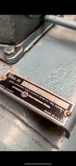

I’m new to this forum.
I picked up an older Quincy x2 compressor.
It was connected to 3 phase, so I replaced it with a single phase.
Seems to run very smooth and quiet!
Is there any value to this?
I’ll try to send a video.
oly
Dec 1, 2023
3
Here is what I have
