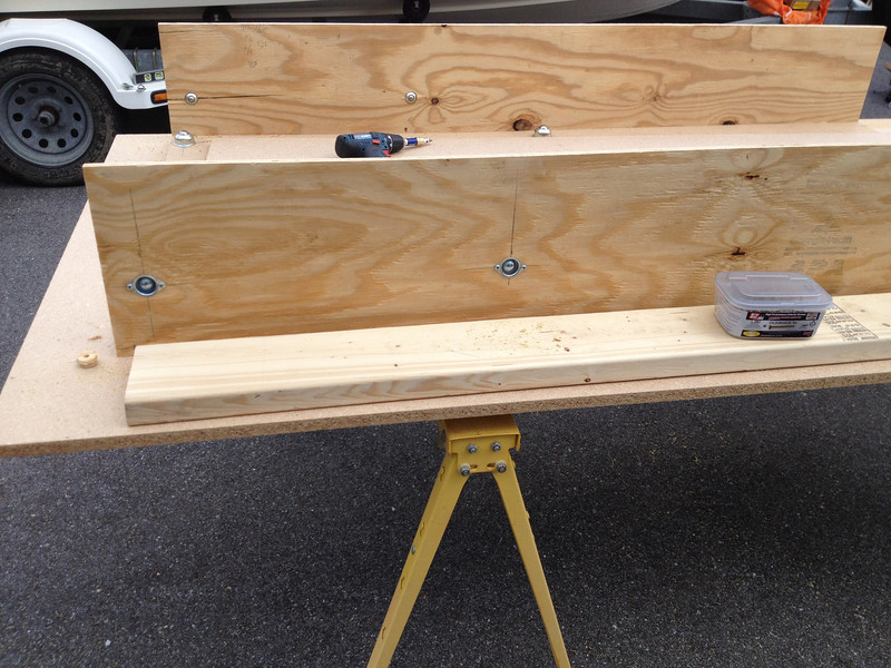

I started out making the the "drawer" slide and used 1" bearing rollers I got from harbor freight. There are 6 of them mounted to the floor and they are rated at 155# a piece.
Since the bearing rollers move 360 degrees I installed 4 5/8" rollers in the side to keep the drawer body centered. I specifically used 5/8" plywood so I could insert the rollers in from the back and have them stick through the wood. This allowed me to make the drawer body as wide as possible.
I dry fitted the assembly to verify I didn't screw up. As you can see this truck has a one piece fiberglass body thing dropped in the bed. It's nice but it makes the floor of a mini truck even smaller.

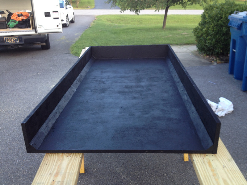

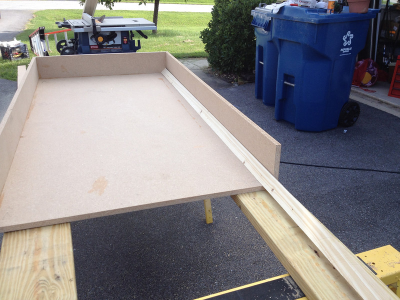

I made the drawer body out of 3/4" particle board. I chose this material for 2 reasons.
  1. It's cheaper than 3/4" plywood.
  2. It's harder than 3/4" ply wood so the 1" rollers won't sink in.
All the joints are made with waterproof wood glue and screws every 6". In order to get more glue surface area since the drawer body will be the structural part of the slide I made a "fillet" piece out of a 2 x 6 cut at a 45.
To make the drawer body nonskid and water resistant I coated it with a can of bed liner with nonslip grit mixed in. Almost makes it feel like grip tape.

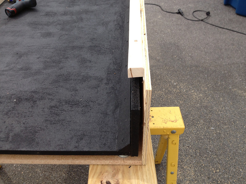

I mounted a handle and two 5/8" rollers onto top and two 1" rollers on the bottom at the front of the drawer.
I added a upper rail for the rollers I mounted to the top of the drawer body to roll on when you start extend the drawer and it starts to cantilever. There is also a slight angle cut to it so the drawer self centers while riding on the top rollers.

It looks great, but I need to warn you (from experience) that you need to seal that wood (all of it) much better. Have you ever seen what happens when a book gets wet and then dries? That wood will expand significantly with very little water. If I remember correctly, we mixed resin and MDF sawdust, then painted every surface with the resin to keep it from warping and expanding. We did this after it got wet and it stopped the issue, but I couldn't believe how bad it was with just a little water. I like the idea if you keep it dry it will be awesome.

The truck is a Ford Ranger with a Miranda Capsule in it. It is enclosed so water shouldn't be an issue. I already coated the drawer with bed liner with anti skid mixed in it so it is in effect the waterproof bathroom coating. I did that more for the anti skid properties than the waterproofing.

I'd go ahead and at least throw a couple coats of paint on it just to get a little bit of water resistance to it. One day you will have to open that up in the rain, and it will get wet. Otherwise, it looks like very nice execution!

I didn't mention it but I did paint all of that bed slide inside and out.

Particle board will absorb moisture right out of the air and then swell and lose strength,
I would paint all side, preferably with an oil based primer first.
