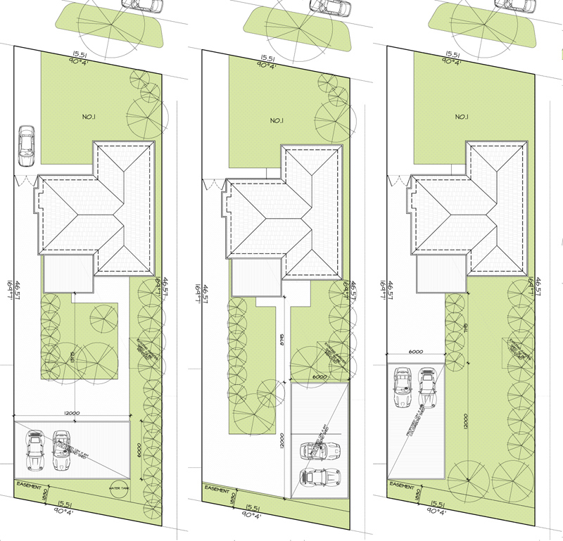

Here's some ideas a mate of mine drew up for me. The house is a small 3 bedroom 60s or 70s house in Glenroy. We're lucky that we have quite a large block, just over 700sqm, so I have plenty of room for a shed.
At the time of these drawings I was thinking of going 12m x 6m, but I since realised that was a bit of overkill and scaled it back to 6x9, which is a standard 3-car size. I've since changed my mind yet again and have decided to increase the size by 1m all round to 7m x 10m to give me a bit more wriggle room.
I'm going for option 1, so there is still plenty of yard between the house and the shed.

hmmmmm .... not quite the 1600 datto I remember from 1969 .. :lol:
Good move going to 7m instead of 6m ...
My lockup is only 6m x 6m ... and I would be rubbing my **** on the wall - trying to change a headlight bulb .... if I didnt have roller doors at either end .. :D

build as big as the council will let you
once you are getting that big its not a whole lot more money and you will appreciate the extra space and it is a big seller for the house when you want to sell and move , its a massive value add
forget option c
option A you lose a lot of the backyard behind the shed
option B allows you to have a good reversing area to then drive straight out to the street and you dont waste space down the back
remember the shed will have to be likely 1m off the fenceline , check with council

I have an easement on the back fence, so I have to build 1.8m off the fence. I'm planning to pave the area behind the shed and maybe add a lean-to so I can use it for storage large materials that can handle the elements (scrap wood, metal, etc).
I really like option B but there's a sewerage line in that spot and it would also send my concrete bill skyrocketing once I do the driveway (the back yard is all grass at the moment). I really like the idea of being able to reverse and turn around, though.

Not that I'll be building my own anytime soon but Im not seeing a lot of concrete square footage differance between 1 &2? When you say 'sewerage' is that like in leach line/perk field or just lateral line? No set back required on sides? In optB you show no concrete in front of whatever the other half of shed is (shop?). Alot more 'work' area in A, looks tight though. Just for day to day B seems more liveable. Id swap functions to put cars closer to house. add a door so not using main door for in&out. Access for pumper truck?
Crude rendition of your plan (If I had space). Might look, at least temp, using gravel or somthing on long drive past house?

how far is the easement , you usually have to build 1m+ from the easement
i mentioned the 1 metre for the fence being the side boundary
not sure of your house etc but i would also consider building it closer to the house which would reduce your concrete costs and then have all down the back as play area garden etc
and could then even extend the outdoor entertaining area to include the side gap between house and shed

I've been told 1.8m from the rear fence. As for the side boundary, my neighbour on the left has an existing brick garage on the fence line, as in the fence actually stops and then his garage wall is the boundary.
I'm not keen on building close to the house, I'd prefer to have it as far away as possible for a few reasons, I can make a lot of noise without annoying the missus, and guests won't have a big shed right in their face when we entertain on the back deck. I don't really like the idea of having play area or garden behind the shed because it would all be hidden.

I really like that idea! Those rough plans were done pretty early on, the driveway in option 1 wouldn't extend all the way to the right side of the shed like that, it would only be wide enough to accommodate the second car, so the width of the roller door (~5m). I didn't consider moving the layout so the two car bays are close to the house and the workshop area towards the back, that's really smart, I might have a play around with that plan myself. The only thing I don't like about it is that it means half of the back yard is taken up by garage and driveway. I really want to find a balance between shed and garden area, I don't want to take over the whole back yard.
Here's the sewerage plan, I hope someone else can make more sense of it than I can, but you can see the line going across the right hand side of the block...
I was thinking of doing a gravel driveway for now too, keep the costs down. I had an idea yesterday to use a series of railway sleepers for the narrow driveway section between the house and fence, I think it would look really cool.

I would suggest that you make each bay have a roller door wether you use it or not is another thing as again this is a resale thing of having 3/4 car garage
gravel drive , true save some money now but 2 issues
1 you will prob reconcrete later
2 its dusty and gravel gets in the car tyres and flicks off , get ready for stone chips
the sewerage for your house is no problem you can build over that , as its not the main line
building on the fenceline, check with council , just because your neighbour has it doesnt mean you can do it today in 2013 , i personally wouldnt build on the fenceline as you will get weeds grow between the shed and fence and it allows someone to enter through the fence into your shed when you are sleeping

- do you have any restrictions on maximum allowable permeable surface? Some of the options that include driveways (i.e. 1, 2) appear to cover more of the yard in hard surface.
- i actually like #3 from a site planning perspective, as it leaves you the most untouched yard. Think dog. Kids? It also gives you the longest site line to the back of your property from the house, which will make the yard feel bigger (less of the garage is seen from the house).
- i know #3 isn't as good functionally , given how the cars would need to be parked, but it gets my vote if I put my "please the wife and family" hat on...
Otherwise I like #1.
