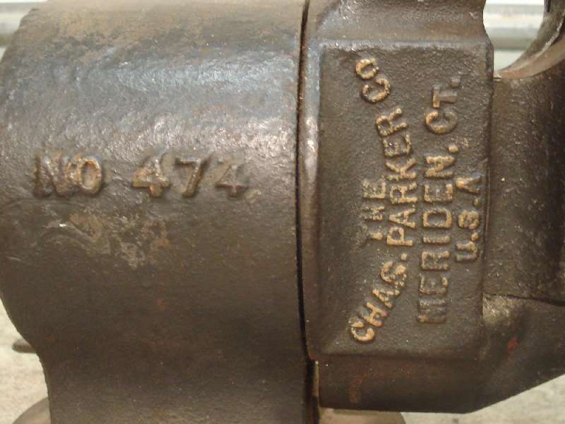

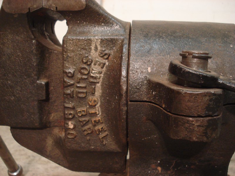

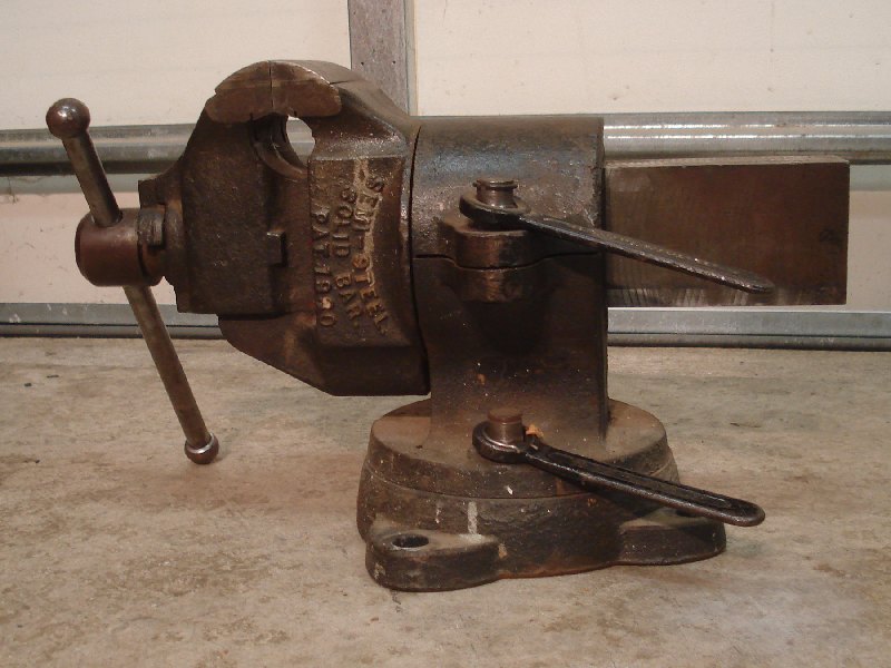

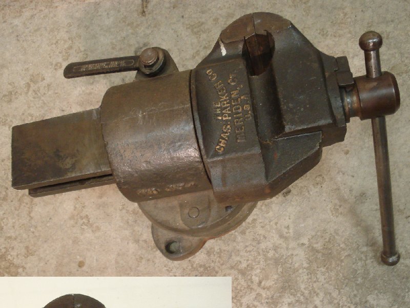

the Parker vise is very nice. rare??
I've only seen the 695 pound railroad vise in an old catalog. any body own one or have a picture of an actual one? just curious
