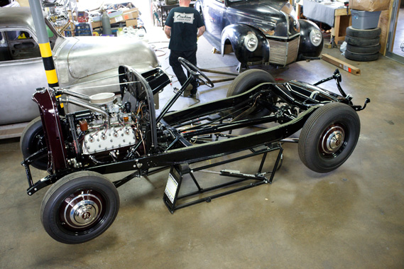

jims09build
Nov 11, 2009
102
I have a QuickJack unit and I think it's great. I built a Factory Five Cobra kit that weights about 2250# and this is perfect for oil changes and brake work, simple to slide it under the frame, it is very low when collapsed which is a good feature as my car only has 4" of clearance. I can store the 2 jacks upright against the wall and put the pump and hoses on a shelf. I bought one of the first units so it doesn't have the new improvements but I still love using it. Here's a pic of the Cobra on the QuickJack. It's only about half way up as I was cleaning the brake dust off the wheels.
Jim in Pa

BenPac nice unit at the concrete shop floor and the ashpalt of the race tract,, but how well will it handle the salt of Bonneville?? Our 28 roadster has the added bonus of land speed weight. Would love to try it out.
