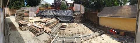

Here is a pic from the perspective of our neighbor's yard to the east.

4AudiQ
Nov 30, 2012
167
PDX
Should not the ecology blocks be staggered so that they inter-lock?
The break between the blocks should not line up with the one under it(like legos).
Subscribed.
SiGmA_X
Aug 13, 2005
1,111
Portland, OR
Subscribed.
That's how I've always seen them, too.
This should be a good build.
R
RSwannabe
Dec 17, 2009
403
Yes, the two rows of ecology blocks should be staggered to interlock them for greatest strength and stability. That is how the east retaining wall is. You are correct to point out that the north wall is not that way. That wall is not really doing much retaining work though, so I'm not worried about movement there. It is more there to match the east wall and secure about a 2 foot elevation difference.
