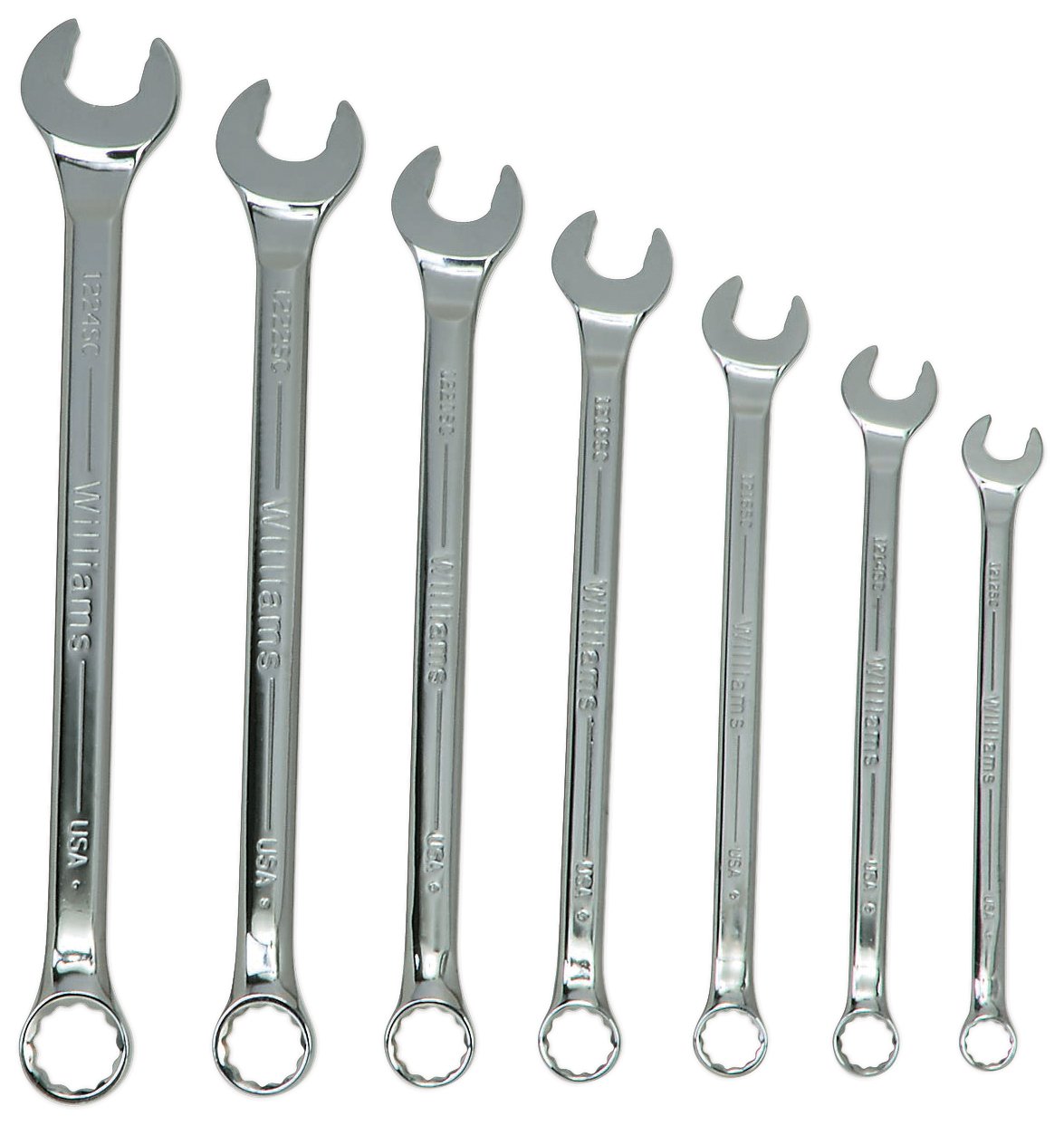

http://www.amazon.com/dp/B0001NQQCC/?tag=atomicindus08-20
Then Id buy some decent wrenches.
The Williams Supercombo......metric and SAE set cost about $177.
http://www.amazon.com/gp/product/B002FHKHJA/?tag=atomicindus08-20
http://www.amazon.com/gp/product/B001DO0V0Q/?tag=atomicindus08-20

Now if ALL I was ever able to spend in life was $400.....well this would leave me lacking ALOT......but its a hell of a start with some fairly decent tools.
Yeah.....Craftsman aint what it once was.....but Ive never broke a socket, even if it was from China. Those ratchets in the kits are a far cry better than the raised panel cheapies.....which is actually what I started out with.
These tools would last you awhile and would likely not need replaced for better quality ones unless you become a professional wrench.
