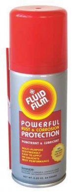

I use Fluid Film on a variety of stuff that I don't want to corrode. Especially good on hydraulic cylinders on the tractor.
A mix of lanolin & wool.

I use that on my work hand tools, but I don't think that stuff ever dries, it's always oily.
I've been trying to get Boeshield for a while now, but no where has it, and the only places that will ship it up here want a crazy amount for shipping.

I use Fluid Film also. My drill press sits downstairs of the garage and the machined surfaces, along with the raw cast iron surfaces were getting a light surface rust. I cleaned the rust and sprayed Fluid Film on a rag and wiped down all the surfaces and I've never had a problem with rust in 3 years now. All it takes is a light application and yes dust does stick, but it's a hell of a lot better than rust. And here in western PA, rust is a way of life.
