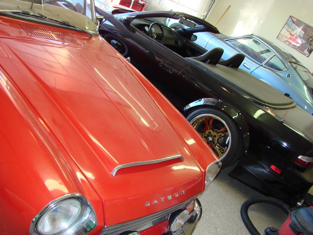

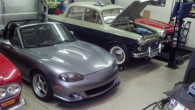

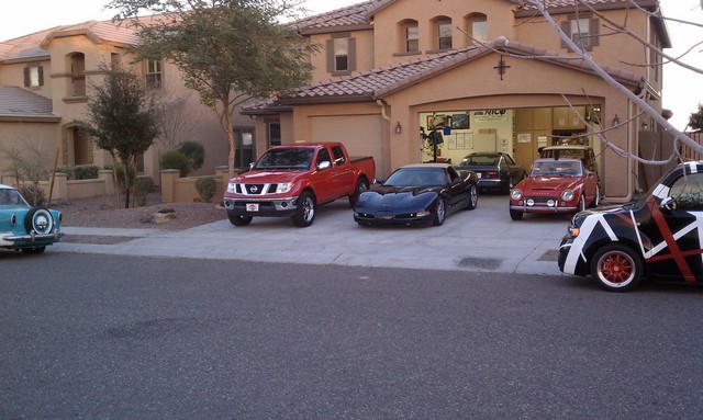

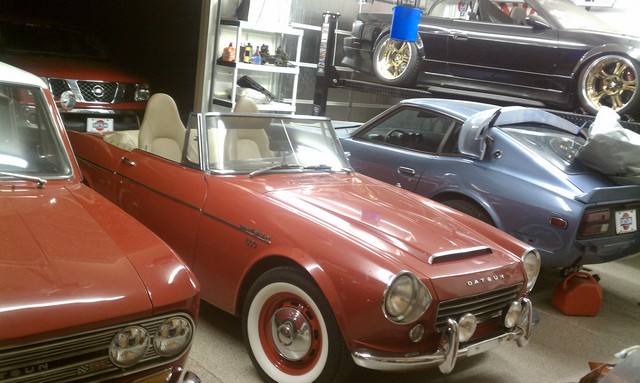

Here's some "justification" pics... why I needed a bigger garage (note: not all cars are pictured, I just searched my files for pics taken inside the garage).
I like to host "tech days" for our Datsun friends... somehow, this has expanded to our other cars as well, so on any given weekend, we might be wrenching on Corvettes, Miatas, Infinitis, or even a couple Model As.

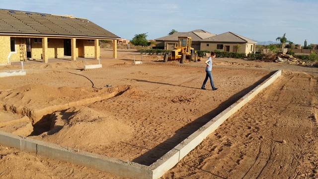

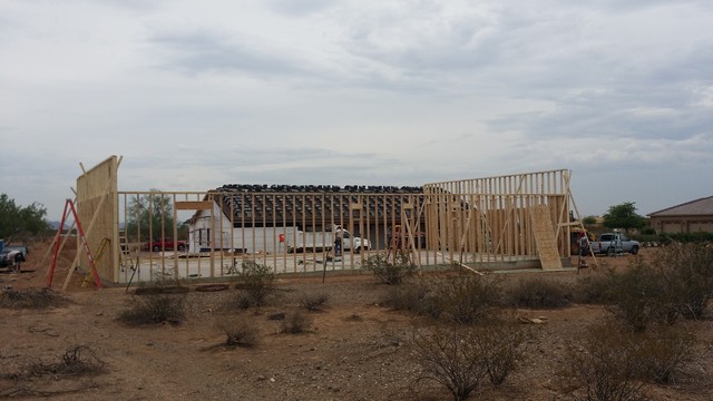

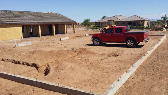

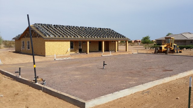

The lot is 1.3 acres... somehow, the pics really make the shop look a lot closer to the house. Anyhow, here's some photos of the process thus far:
Stem wall / slab prep:
Becky (my spouse / partner-in-crime) walking the plot:
The NICOclub.com Tow Vehicle posing "inside the garage":
Plumbing and ABC down:
Slab poured:

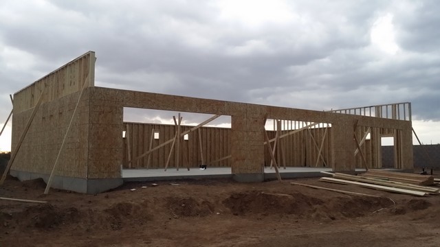

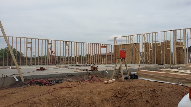

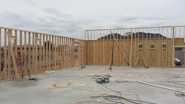

Walls going up:
...and one of the many reasons we love Arizona:
A
AZhitman
Jun 8, 2014
104

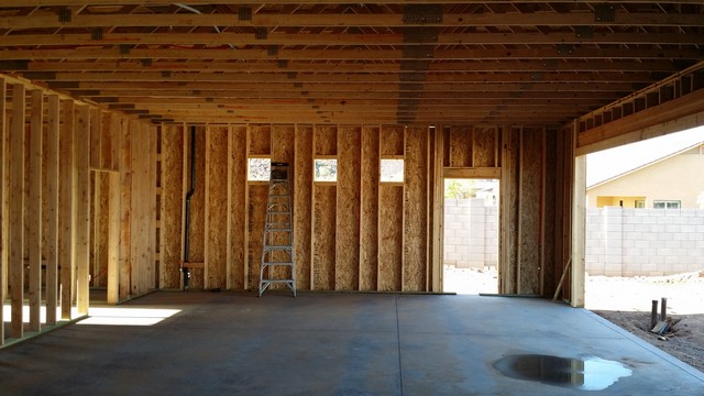

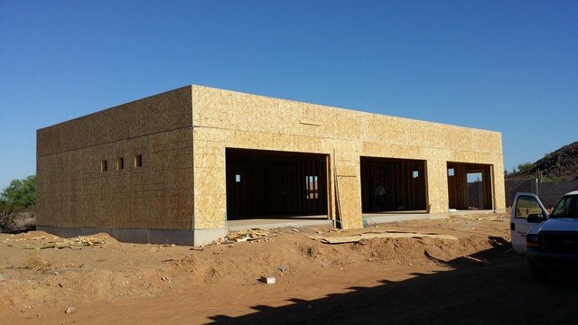

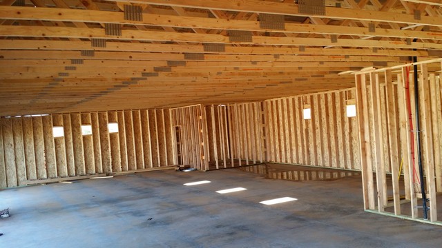

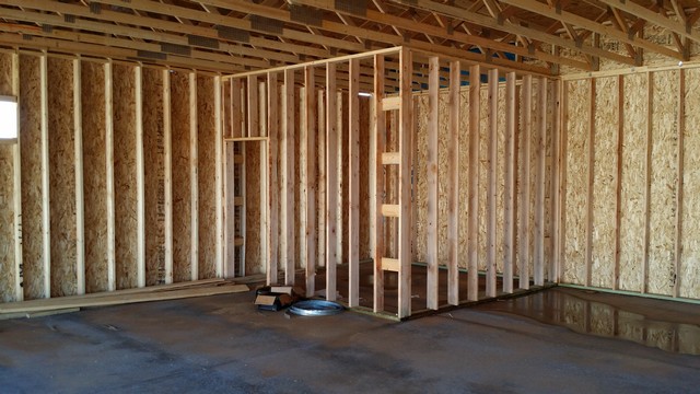

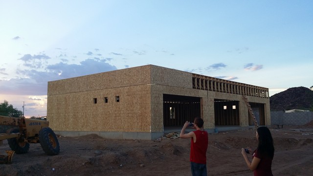

I wanted to get a little natural light inside, without exposing the interior to too much of our scorching desert heat... so, you can see the 18x18 double-paned argon-filled windows (and a larger window in the "bedroom" area per building code).
Doors will be 3x 16x8 insulated standard doors. Roof will be flat (pitched 4* front to rear), coated in polyurethane foam with an elastomeric coating.
Three scuppers on the rear of the building will handle rainwater (5-6 times a year when it rains) and the entire roof will be home to solar panels (to power the shop and the house). The "parapets" will conceal the panels from view.
Here, the OSB is going on, and you can start to see the "shape" of the building (such as it is):

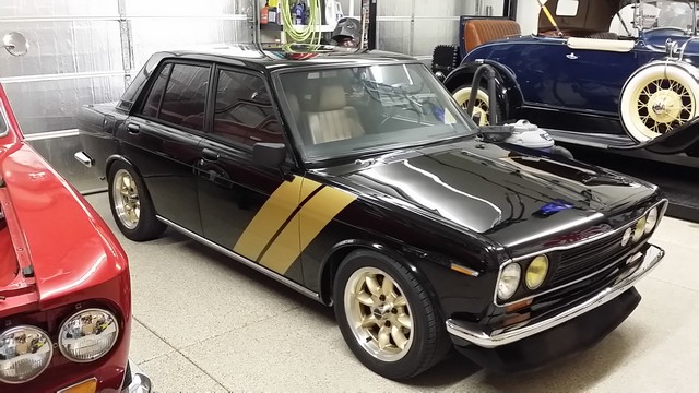

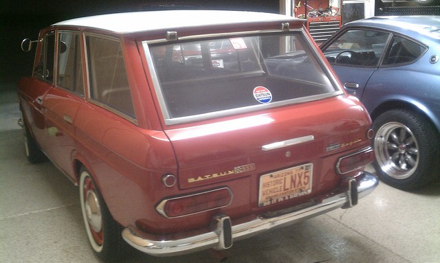

red convertible, red wagon and green and black sedan are all cool do not guess I am familiar with those vehicles. What are they?
Thanks, LSB!
Red convertible is Marilyn, a 67.5 Datsun Fairlady Roadster with a stroked 1600.
Red Wagon is Alice, a 67 Datsun 411 SSS with a stroked 1600.
Black / gold sedan is Betty, a 68 Datsun 510.

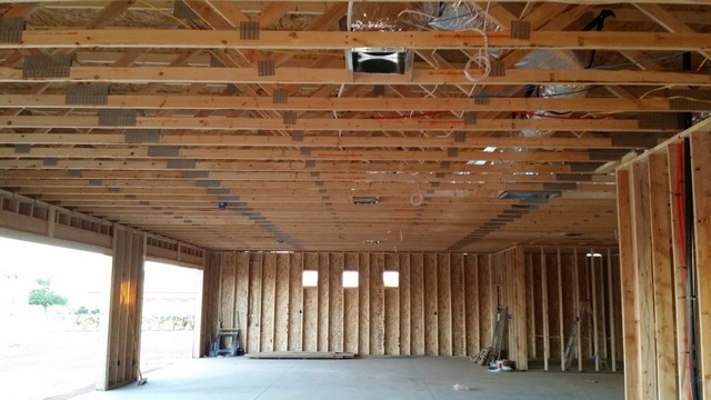

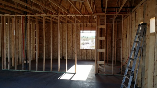

Electric (first round) and plumbing are in, as well as HVAC.
5.5 ton Trane unit should keep it reasonably useful when it's 118* outside, and more importantly for me, it'll warm it up in the "winter" (I have a tough time when the mercury drops below 60).
Electric got roughed-in before I had a chance to "direct" things, so the contractor will be back out here to redo it. Going to max out on outlets (per code) and keep all outlets in work areas at 4' height.
Installed an 8" vent with cap over the "dirty room" to evacuate welding fumes, and I'll be building a vent hood (like in a pro kitchen) to come down over my table... need to find a good, inexpensive inline 8" fan that'll move enough air to be useful.
More pics to come this week - Thanks for all the supportive comments and ESPECIALLY the suggestions! I want to do this *right*, but I'll admit it's all a little overwhelming. :)
