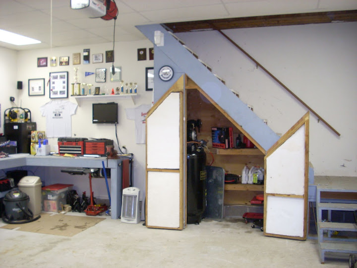

I have my compressor in a closet in my garage. I'm thinking about adding a zig-zag portion of pipe to get some extra piping to let the air cool. Originally I was thinking about putting this next to the compressor, but have concerns about space as well as heat from the compressor.
Would it be ok to route the copper pipe outside and do the zig-zag. This will allow me to use whatever length I want and the ambient outside temps will always be cooler than the compressor closet temps.
My concern is freezing. Since the point is for this section of piping to cool and condense the water to drain, freezing may be an issue as temps get as low as the 20's or even teens.
Here is what I would like to do. It would require having a drain (ball valve) outside.
Is freezing something I need to worry about? Will it condense enough water to be a problem? Do I have to worry about the pipes freezing/cracking, or just the valve sticking, or what?

Hi Torque. Unfortunately taking the compressor out of the closet really isn't an option for me. I plan on putting a vent fan to the outside in the closet and possibly a box fan over the tank/compressor and run them when I use the compressor.
I have an 80 gal 5.4hp belt driven Craftsman compressor.
