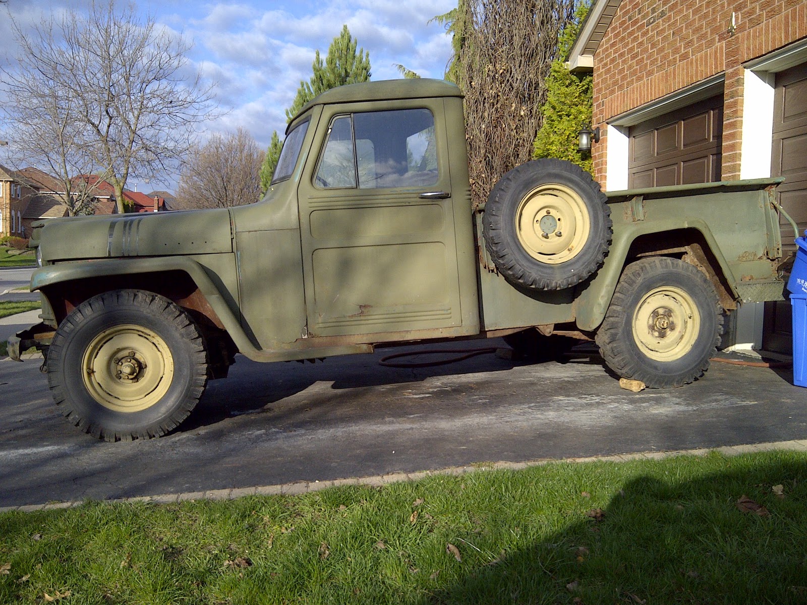

While poking around the scrap steel bin at work, I came across some nicely welded roll-formed channel and said "hey, this will bolt up perfectly to my frame." So I brought it home and chopped the lengths I needed (it's in the background of the pic above). I also grabbed my wife's grandfather's homemade toolbox, and loaded it with the tools I'd need for towing. As a side note, I love this box, I might have to make a few more for myself, they look real real easy.
The first order of the day was fitting my new custom tow mounts to the frame. The frame on the Willys trucks have 2 holes near the front of the rail for the bumper, 6" apart. the pre-punched holes in the profile lined right up. I also fed my heavy safety chain into the channel and passed a mounting bolt and the tow pins through it to secure it. This whole setup was cheap as free, everything was repurposed. Scrap steel frame mounts from the garbage bin at work, the coupler off a junk piece of farm equipment, the tube steel off a 1960's railing I took out of the house, bed-frames for the angle iron stiffeners, even the hardware and pins were cast-off used hardware from work. at $0, this was great.
Next Step was fitting the Fleetmaster DeepLug on the back. what a cool looking tire. This is the spare off my other Willys truck, and I'd never used it. Note, Willys uses a reverse thread lug nut/stud. This is very perplexing the first time you go to take the wheels off.
The final order of business besides cleaning around the truck was to mount up the towing lights. Again, I didnt drop a nickel on this. The wire was all old trailer wire, and the lights I've had for years. They were on sale for $4 at princess long ago. A few holes and a bunch of zip ties and I was off. My dad threw together a nice 'In Tow' sign, as you'll see, as well as some pylons in the back so it all looked official.

As these things go, I forgot to take any 'en route' pics. Frankly, I wanted to get it all over and done with. I had the t-case in neutral for towing, and had done a few test runs to check the tracking, etc. With all systems go, we hit the road.
It took about 45 minutes to do the 14km drive, sticking to max 25km/h. Given the time of day, almost nobody was out, which lightened the stress levels.
I was fairly impressed with my hitch setup. It seemed plenty strong and the safety chains were probably overkill.
With my dad's Jeep out of the picture, I had to get the rig up the driveway, so I had nabbed the gas tank out of an old riding mower a while back. A few more zip ties had it secured to the grille support, while a hefty magnet and scrap chunk of aluminum ruler formed a temporary support for the bottom. A few lengths of rubber gas line allowed me to route it through an inline filter and a small shutoff valve.
The old battery needed a jump even after a few days of trickle charging, and with a quick swig of 2 stroke mix fuel (all I had on hand) down the throat of the carb, the flathead 6 drew breath and fired off, filling my neighbourhood with a nice plume of 2 stroke smoke. After easing off the choke, I slipped the Spicer 18 transfer case into low (no brakes, remember), and clicked the 18" shift lever into 1st, gently maneuvering the rig around to line it up into my driveway, where it sits for now, waiting for some much deserved love. I think this has got to be as good a shop truck as any, I can even picture a hand painted old-style logo on the door.
