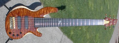

Here's a few of the photo I saved of some basses. I build only extended range basses (5 and 6 string), 35" scale. There's a single exception; 4 string that a friend bugged me for so long to do that I finally just built it to shut him up:)
The first commissioned bass was a full width 6 string. I called it the aircraft landing strip because the fingerboard was so side (4" at the body). It's bubinga and maple. Needless to say it weighs a ton but man does it have a full range sound. I also built the same guy a matching fretless.
There a common theme of having eastern hard rock maple in the necks but the alternating woods were bubinga, figured myrtle, figured maple, spalted maple, figured black walnut, and lacewood.
This is just to give a general idea of the neck through body bases.
