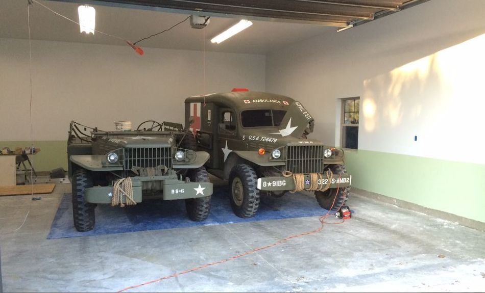

A little background on me. I raced automobiles for many years, but have now transitioned into my longtime passion which is US WWII history. I started collecting artifacts here and there and then started restoring vehicles on the weekends. I have posted the progression of my garage on some of the military forums, but it is probably more appropriate here.

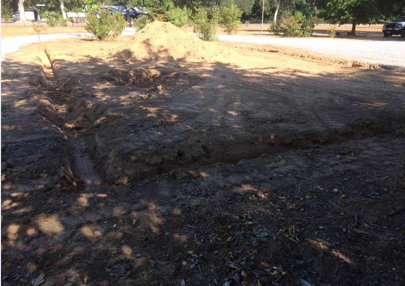

Initially, I wanted the garage out behind the house, but my wife said that if it was she would never see me again. Therefore, I had to squeeze it into the front yard...which leaves room for an even bigger building someday in the back...:

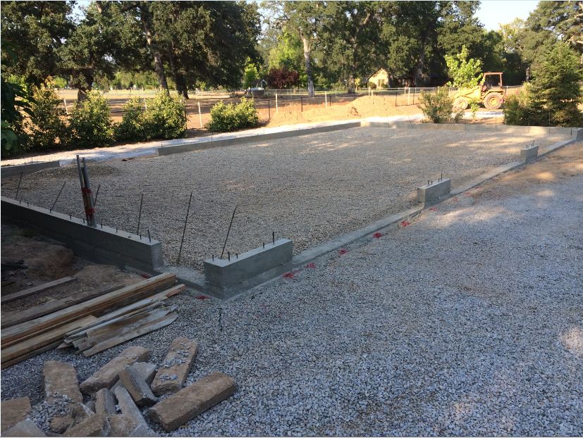

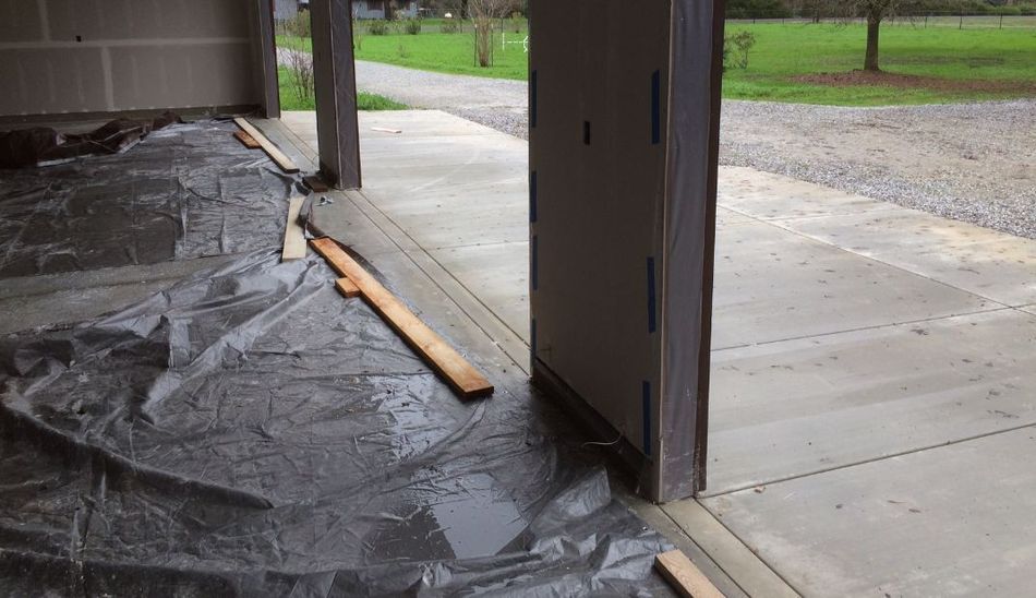

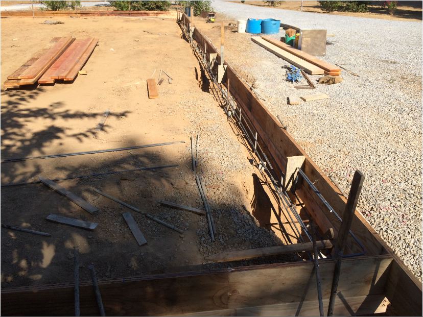

I elected to have a 6" stem wall all the way around. I figured that if I wanted to hose it out, I didn't want the sill plate sitting right on the foundation. I don't know why, but I just did. Lots of rebar in this concrete slab and footings. I live in California, so this building must withstand the equivalent of two direct nuclear strikes at the same time and not waver:

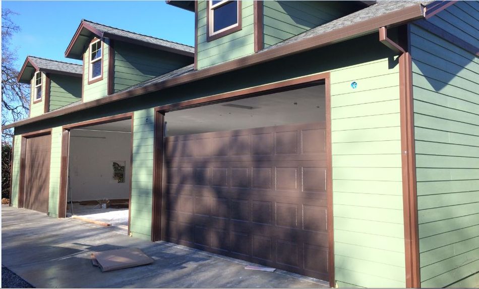

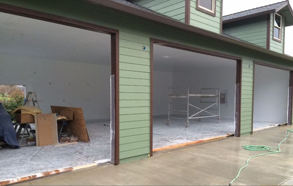

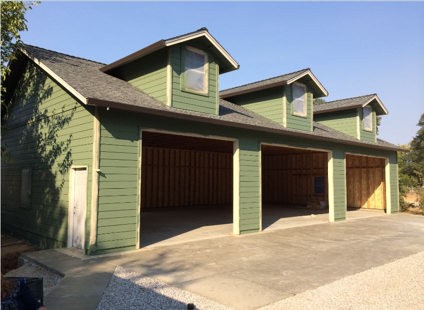

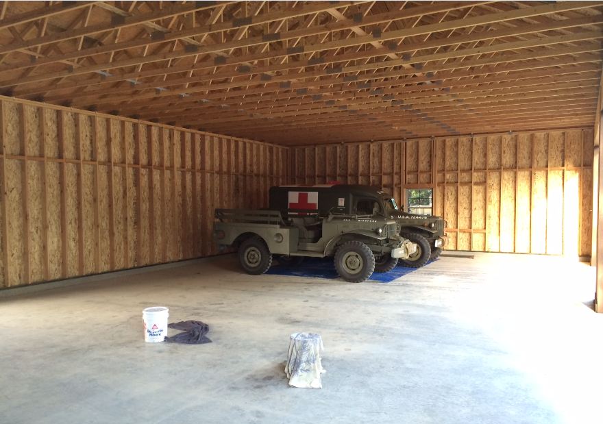

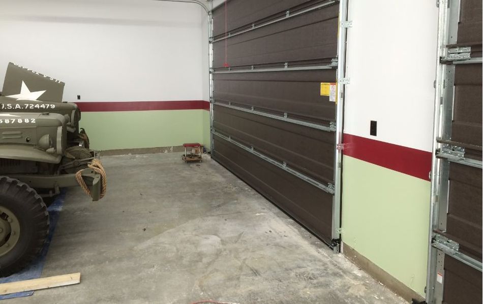

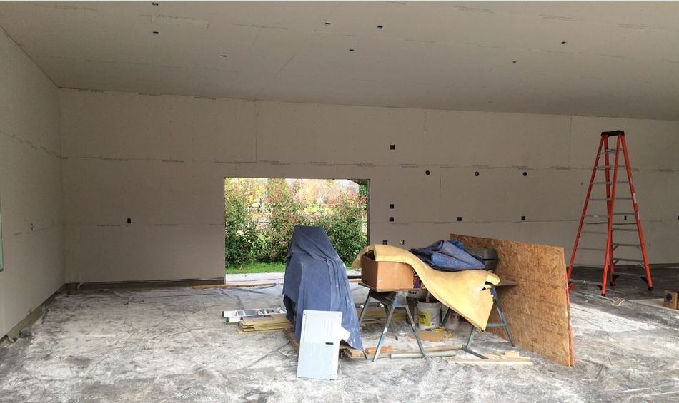

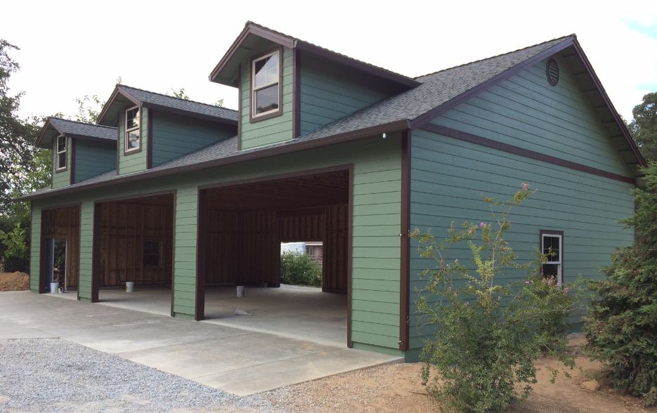

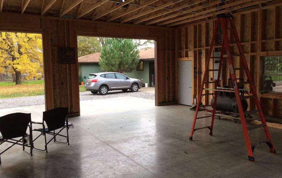

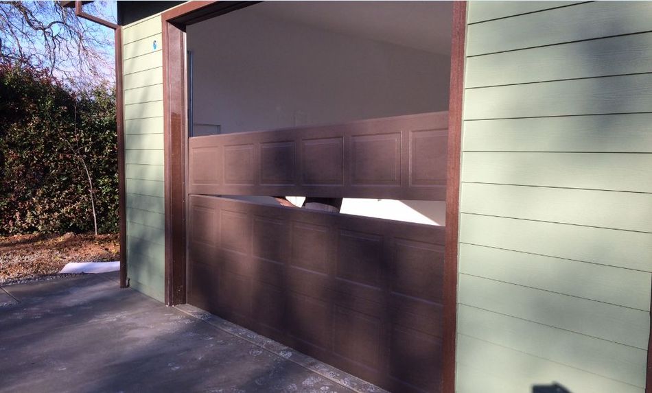

My layout is 32' x 60' with two small windows on each side. Two 16' x 10', one 12' x 10' and one 10' x 7' garage doors. The small rear door is to help with ventilation as it gets hot here...110 plus in the summer. It will also allow me to keep an eye on the neighbors:
